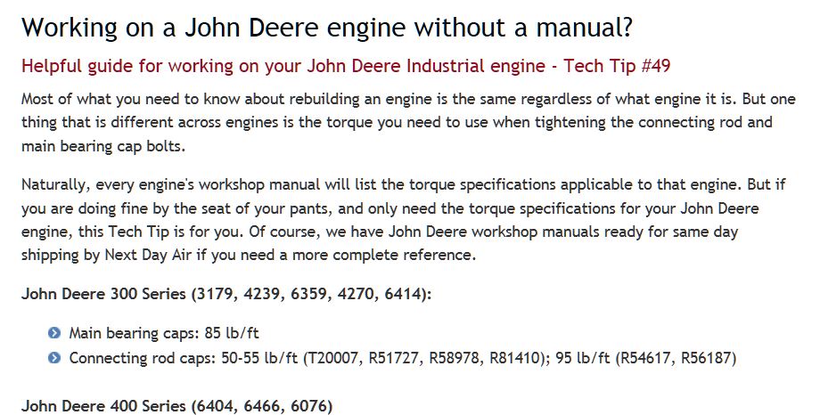

Rebuilding my JD 1520. I need a link to rod bolt torque and head bolt torque specs. Can I get a little help here???? Many thanks in advance.
   / Engine Torqe Specs for 1520 John Deere #2
For the 2030 (I know it's not a 1520) head bolts, lubed with engine oil, torque is 110 ft lbs.
Rocker arm shaft mounts to the head 35 ft lbs
Rod cap screws 65 ft lbs.
Hope this helps.
You could compare bolt sizes between the 1520 and 2030 at JDparts.com
   / Engine Torqe Specs for 1520 John Deere #3
This is what I found on Google
Hey appreciate the quick answer. This is all that is holding me up and I think the 2030 carry the same rod. Time to get this up and rolling!!!
Just letting you all know, got this baby put together, getting ready to crank. Thanks for input.
