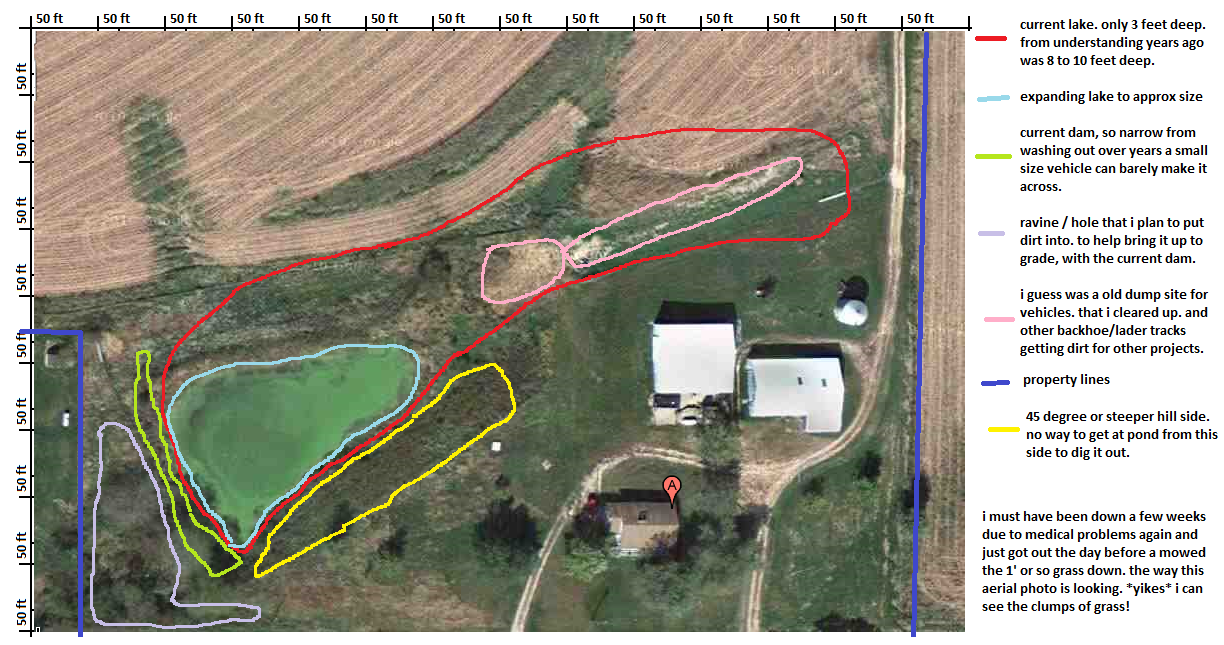

this is one of them multi year projects. as i work around the weather, and dealing with all the other projects.
maps.google.com
"print screen button"
edit->paste-> into microsoft paint
edit->paste-> "transparent selection
edited different areas from google maps.
the dam is to small to get the 555C loader/backhoe across it. so i had to build a quick culvert at other end of current lake. to get across and around it. bad part of it is. all the run off water goes right through that area. so only time i can work without constantly getting stuck is when everything is mostly dry.

multi problems that need to be deal with this lake.
pond use to be approx 10 to 11 feet deep. and now 2 to 3 feet deep (3 feet is pushing it) and just tons of silt from nearby fields have ran into it. filling it up and turning it, into basically swampy mess.
over the years i have looked into what it would take to clear the lake back out and gain its depth.

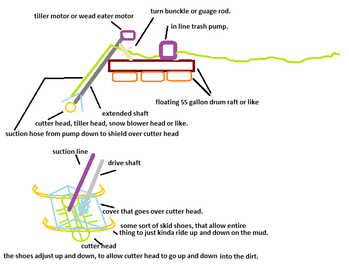

the above stemmed a couple problems. the first problem. i may need a cutting edge. down in the water. to help stir the dirt / muck up. so it will more easily be sucked up.
and the other problem. is limited by height say 5 to 8 feet max height. i can raise end of hose up.

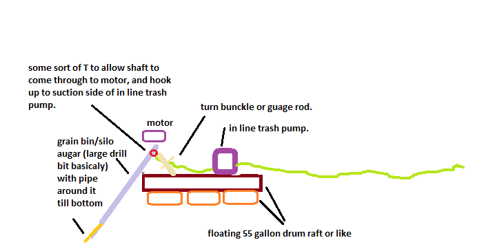

on the first problem. i started thinking of how i could setup like a small little tiller head on end of pipe. for example could i take a gas powered weed-eater with a straight shaft. and then get its little tiller option they some of them have. and just make a long shaft that goes down into the water.
could i perhaps get a small 10 to 20 hp riding lawn mower engine. and some how setup a 3pt hitch setup to run a post hole digger with longer attachments for deeper depth.

i then thought about modifying an out board motor. for a small bass boat. that ya just set down on rear end edge of the boat. hook up a small battery if need be to start it. and just extending the shaft and perhaps propeller down. my confidence in went down, after listing to my uncle. having to replace multi propellers, drive shafts, engine seals etc... due to hitting a rock. or getting it into the mud.

looking at the units available. it is what i have been wanting to DIY. pontoons vs a dock made out of 55 gallon drums. i can live with that. they have figured out and done math for pump and engine. so if rocks / mud / slurry goes through pump you are not damaging things ((more or less a booster pump)). and have a secondary pump for "jet" use. get more suction at the nozzle / suction end of hose. some units have a trash pump setup were you drop the end of pump down into mud to stir things up and pump the mud out. some come with extra pulleys and like. so you can put some guide wires around lake. punch in some control commands. and let the entire unit move around automatically. and just go out with a boat to fill with gas. or pay for high grade 220 or 110 electrical line cables to the unit.
i do not know any better. because i have never done it myself. but i am dis-appointed. in not having some sort of boom with a snow blower or tiller head attachment on the end of it. even just a little 4" to 8" or up to a couple feet wide. with a small hydraulic cylinder and hydrualic motor on the unit to raise and lower and run the tiller attachment on it. surely someone could take say a 5hp engine or like and a smaller pto pump match things up. and go. put up some guide wires. and if need be a hand crank. and a couple gears. to pull / push you along the lake bottom. just like if you were tilling, but in this case, tilling and sucking up muck and water and pumping it away.
perhaps it is a simple combination. of having enough suction power without need of some sort of tiller attachment. and mud to water ratio that works out. and a tiller attachment would over load water to mud ratio to a point of being to much mud. and setups are geared for silt, and less harder compacted earth. and companies figuring once ya hit that hard of dirt. you would be better of draining the smaller size lake and getting in excavators, and dozers to do the work.

so at this point in time, i am thinking about busting a hole in the dam. draining the lake, and as it dries, slowly trenching into the lake as time allows. to allow the "spoils still in the lake" to dry and allow the water table for area and water in the spoils to drain out, ((basically turning the lake back into a ravine)) for a few years. so that i can, then just drive right on top of all the silt and either use the 555c TLB (tractor loader backhoe) or perhaps at that time get a used dozer, and as time and gas and cash allows digging things out.
it is either above, or see about finding a used mini dredge. and pumping the stuff out. both have there con's and pro's. right now i have a well that requires the water table in the area, to keep it full of water.
on other hand. i still need to move tons of dirt on opposite end of dam/lake. and dig things down to 1 to 2 feet above current water level. as more of prep work. so when it comes time. for spoils perhaps it will be a quicker doing.

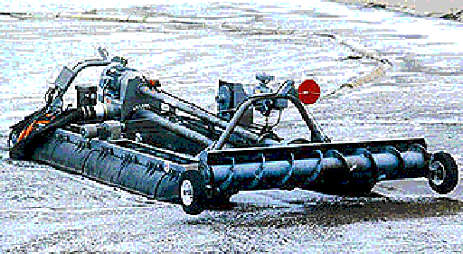

Have you seen a "hydro rake"?
I've seen a few stories of these being used in the news.
I don't know what guys who run those charge to dredge a lake, but if it was at all reasonable I'd be tempted to just have them do it.

the motorized rake you show. looks nice! and for some folks, that unit may be just the key to some areas of there lakes for temporary doings in attempt to reclaim there shore lines and lower depth spots. i would imagine it also allows folks to help rip out roots and bulb like plants with ease as well.
though i would imagine. that piles of vegetation happen right on the shore line just within the water. due to not being able to drive the unit up onto softer dirt. and perhaps needing backhoe or excavator. to pull the piles once made up and out of the lake. so the decaying matter does not harm the lake.
as far as swapping rake for a bucket. hmmmsss. don't know about that. would have to get on the unit and see how fast it would move across water with full bucket of muck. and how big the bucket was.
as you noted, hitting bucket up against the flotations. and looks like only way to get full depth digging is straight down center between the 2 floats. which would be very limiting factor :(
