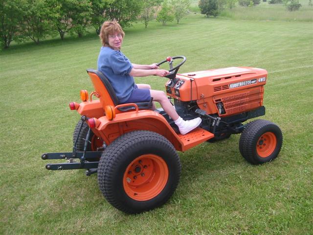

I have a nice old B6200HST with 15HP. I have been using a back blade to remove snow on my flat blacktop drive. I am looking at buying a used 52" 3PH blower. Owner states it worked very well on a 20HP Deere.
If anyone out there has experience with a similar setup, I would appreciate hearing about their results. It looks like we might get a lot of snow this year. The back blade works fine, but as the snow piles up, the only place to put the snow is out in the court. Thanks.

Thanks for all your replies. I will post my results if and when I get it.
   / Enough HP? #8
That is a clean looking tractor... Very nice.
   / Enough HP?
#9
I wish it was as bright orange as that picture makes it look. In its past life, someone loved it enough to put some really nice hand pinstriping on it. It is a surprisingly tough little tractor.
