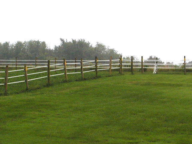

Has anyone used the electric fence mesh? I found a website for HorseGuard products, and I was thinking it looked like an economical way to get some pastures fenced off.
I'm still clearing our land, but I've got a large enough area for the girls to start in, so I was thinking of using this along the "frontier", and as I add more area I'd extend the fence out with this type of product.
I plan to use traditional vinyl or wood fencing along our finished side, and I'd incorporate the mesh fence along the other sides.
Any and all feedback is welcome!

horseguardfence...use it, love it. Just finished fencing in about 3 acres (see attached). The fence to the left of the picture are 4" x 4" posts while the posts to the right are covered T posts. I have another field that has a 4 rail (1" x 6") fence where I've run it on the inside of the top rail. The charger is a 6v solar Parmak. Any questions, fire away.

We use the horseguard and are very happy with it. I have six acres divided into three pastures. Used it now for six years. I have vinyl cover supported 4x4s in the corners with t-posts covered by white PVC pipe as line posts. I run two lines charged of the good stuff top and bottom with some uncharged cheep stuff in the middle to make is look nice for the S/O. The one area to think about is keeping grass/weeds off the tape. I can get under it with the riding lawn mower but need to trim/kill the grass around the posts once or twice each year. One of the bigger benefits for me was that ability to make changes. I don't think there is a single original post from when I started using the tape, seems like we need more pasture or a different layout each year. Our neighbor has the braided rope with a former stud, now gelding that ended up hanging ribbons to give better visibility. Low cost was a big plus for us, ended up spending less than $1 per linear foot. Two weeks ago had a mare slide through an internal divider fence, the lower tape. Broke the tensioner bracket and stretched the fence a little but no breaks in the wire mesh. Replaced the bracket and retensioned the tape. No marks or damage to the horse.
