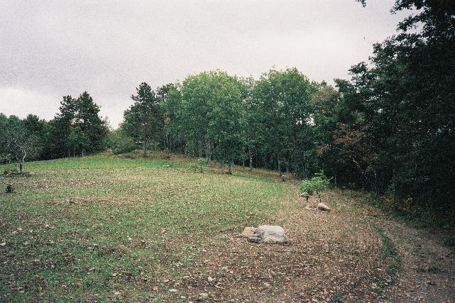

I have done it with a 16 HP tractor and 44 in tiller on 50 year old sod. About 7 or so acres worth. It goes faster than one thinks.:D :D
A picture of part of the tilled area.:D
   / Equipment Needed to Renovate Pastures #9
Egon,
About how long did the whole project take??? Had to be quite time consuming...
