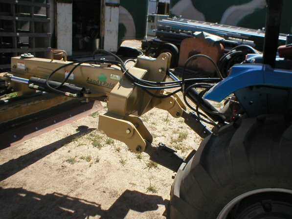

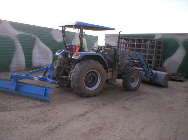

Is that hoe big enough, specs say for 45hp and smaller? You could still go with the next smaller size rear blade. Look at Land Pride, they have gross weight ratings on their blades. An RBT4096 Land Pride RBT40 Series Rear Blades would work good for you, weighs in about 848lbs, good up to 9600lb tractor, 100hp 2 wheel drive.
I have a Land Pride RBT45108, good for a 15,000lb tractor, 125hp. These are big blades, my 75hp tractor weighs in right around 12k and this blade
is about all that I would want. The blade that you are looking at is in this size range and your tractor is a bit smaller than mine. While you definitely don't want a blade that is to light duty for you,(been there done that :eek:) It would not be good to get a blade that is to big for your machine either.
The blue blade is probably rated for a 50hp tractor, I bent it the first time that I used it, dealer said that it should have been fine and that I abused it and they would not do anything to help me out with it, and I had just spent 40k+ with them. :mad: I continued to use it and it continued to bend in different places. I finally bought my LP blade about a year ago and am very happy with it. :D
Good luck with your stuff, double check before you buy.;)
