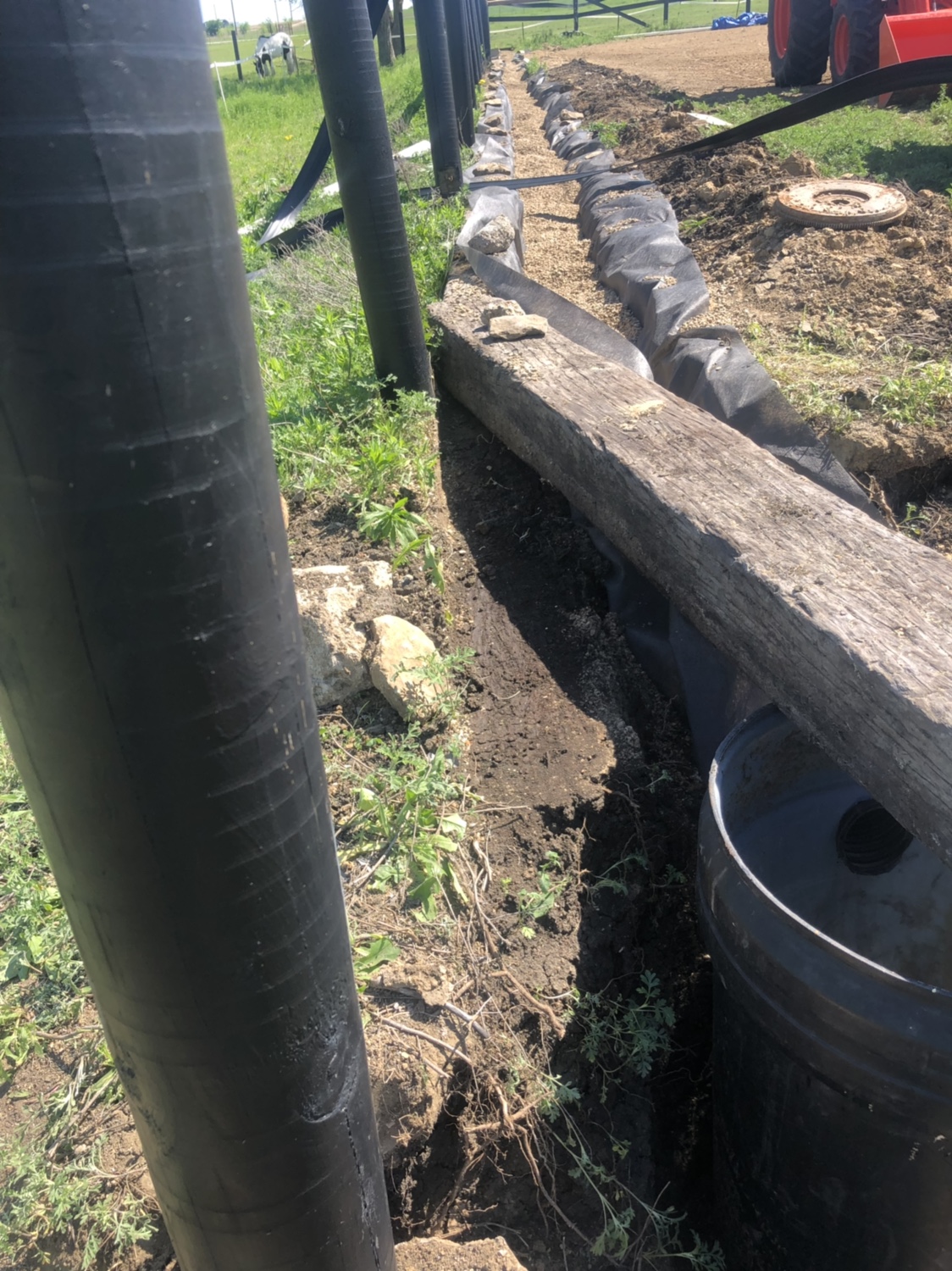

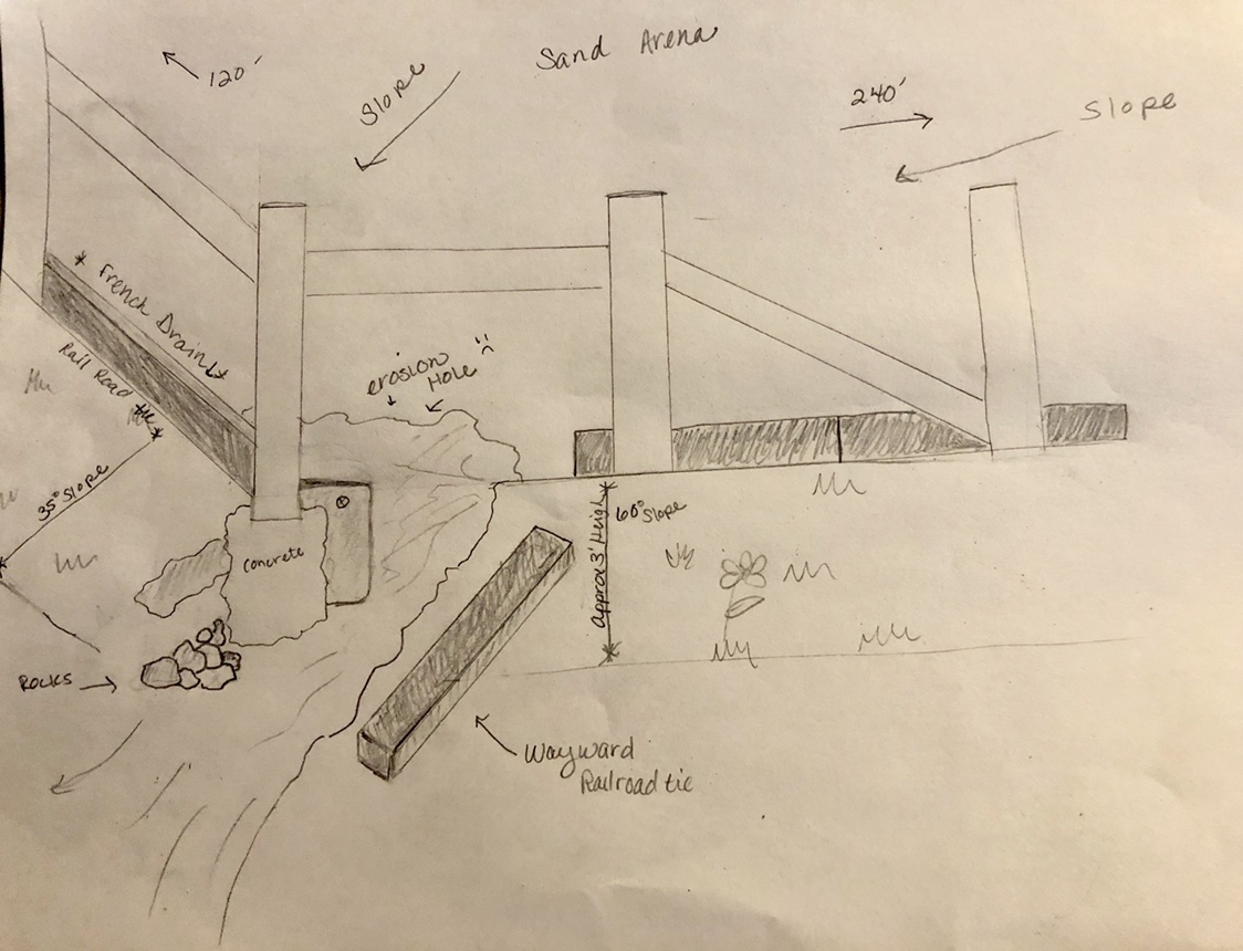

120x240 outdoor arena. 6” wood posts for RAMM flex fence and railroad ties along the bottom to keep footing contained.

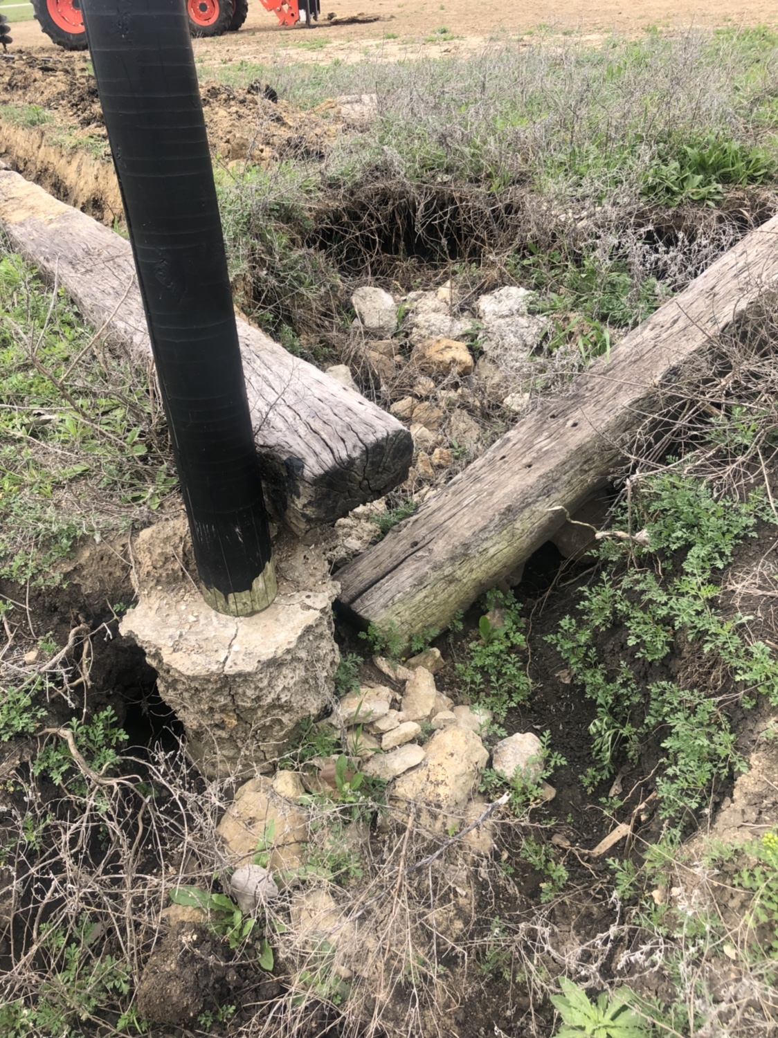

Long story short, I’m replacing a lot of posts and redoing the drainage as one corner is badly eroded; exposing the whole height of the concrete footing and 80% around of the corner post. It has tweaked the whole corner bracing assembly (crooked AF!) so all 5 posts involved will need to be worked on. That corner is built up about 3-4’!
I put in a French drain along the whole 120’ low end with a dry-well/catch basin in the giant eroded whole and will be putting overflow spouts on it leading out and away from the posts.
So my question is:
How should I go about installing the new corner post since there is no soil or anything there yet? I guess I could fill it in first, but that would require a retaining wall and even then, the soil won’t be very packed and I planned on most of that corner being filled in with gravel and the outside of the corner with large rocks from the pasture.
If I try to set a pier and backfill around it, what’s the best way to keep it level, plumb and in line with the other fence posts since I will have to move and reset the other 4 supporting posts along with it? IMG_5498.jpg

Well I do have it set up to drain better which will help a lot in the future, but I need to get my fence up ASAP because I need my arena for lessons. I think it might take too long to build it up and get it packed down enough to get my tractor close enough to auger out new post holes. I have some scrap pieces of railroad ties that I was going to stack under the existing ones (when I put them back in place) that will kind of help separate arena fill dirt and the large rocks I grow in my pasture on the outside of the slope.
I thought of doing a nice little block retaining wall around that corner but it’s in a paddock and horses are azzholes who destroy anything nice so small boulders it shall be!

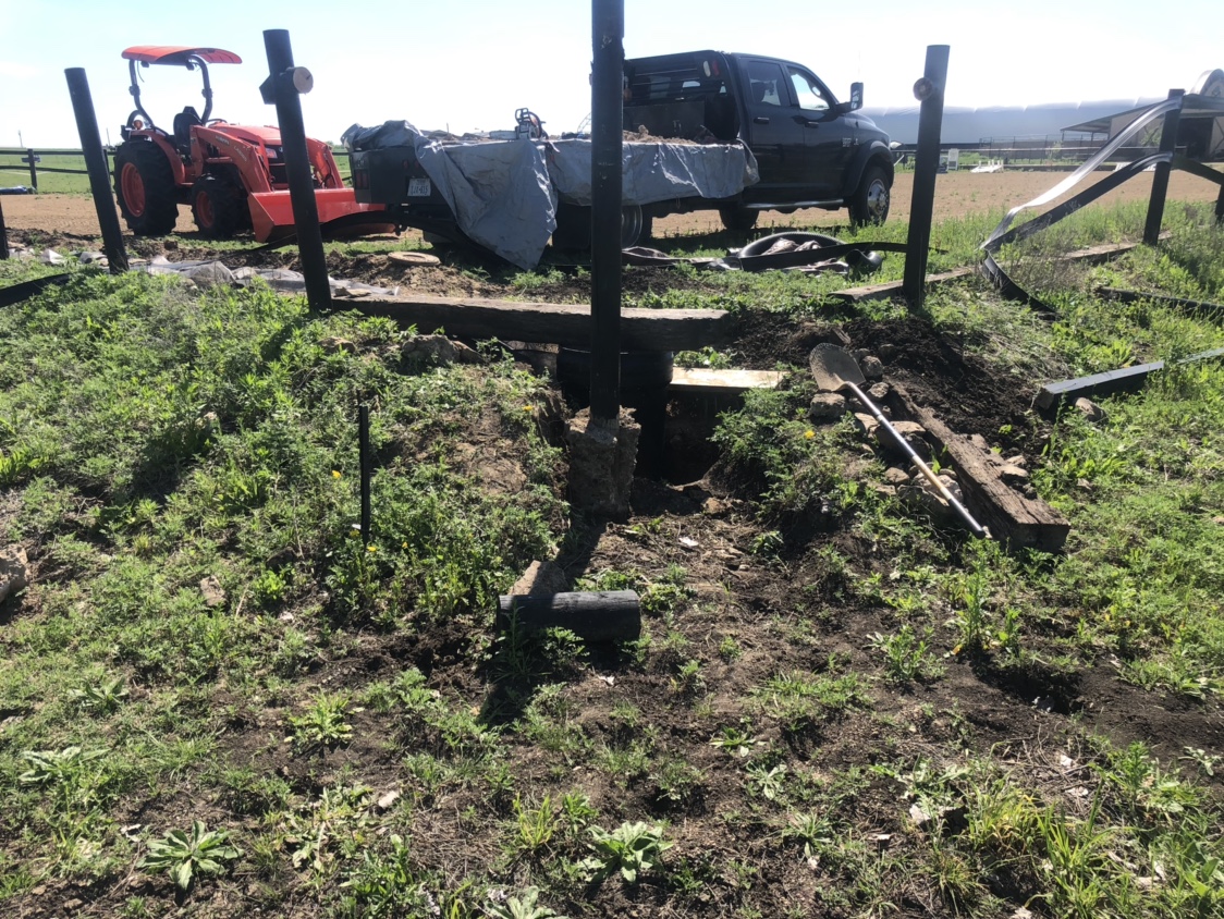

I got better pictures today... keep in mind that I’m a single lady and I do 95% of the work by myself. I replaced 12 posts already and dug that 120’ long trench the old fashion way by myself... I’m exhausted but want to do this right... I just need it to be a one man job because I can’t afford to wait on “weekend warrior/maybe after my kid’s soccer game” people.

Assuming you can get to the downside of the fence easily - I'd plan to dump loads of stone (57, something that will let the water flow) down below the corner and build it up to the level of the arena. pipe your french drain through it. But first auger a hole in the corner and drop a telephone pole in it.

A quick fix to get you back to lessons is needed.....Can you auger and pour in a sono tube a concrete pier or a concrete post (with rebar).

So my corner posts are the larger 6/7” x 8” round PT posts. I’m having a **** of a time finding the right sized sonotube for them in stock Any decent diy sonotube substitutes that would work?
