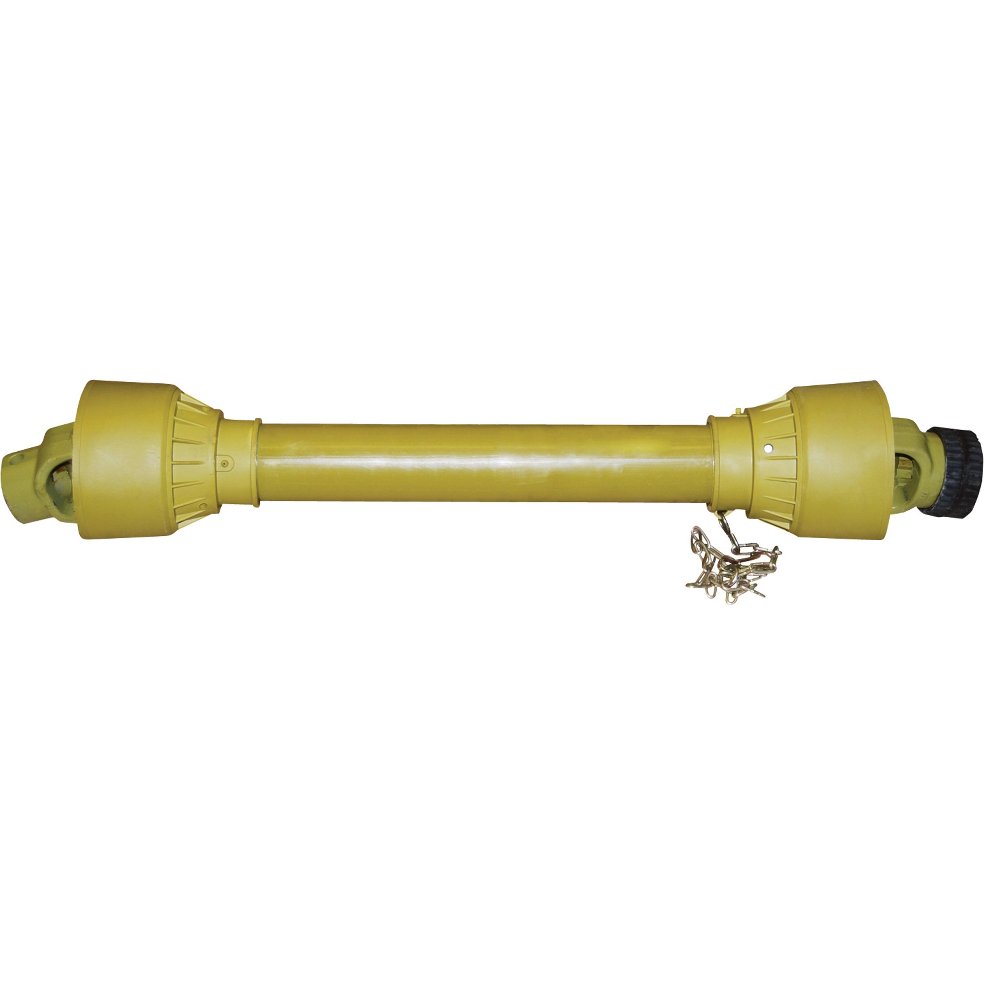

Does your mower have a slip clutch?
Can you post a pic with the entire pto shaft from tractor to mower gear box in the pic? From the side, so we can see it?
   / Erratic PTO rotation #10
The shield on the pto is only clipped at the tractor. The shield covers about 2/3 to 3/4 of the length of the pto shaft so there is a clear bit of uncovered shaft on view at the mower end. This is the end I can see varying speed of rotation.
The shield is supposed to be full length. It's in two parts. One slides inside the other so the shield is not damaged as the PTO shaft length changes when you raise or lower the implement. Someone would have to have removed the other part of the shield. The uncovered part of the PTO shaft would be a safety hazard for people who got closed to it. All my PTO shaft shields have only one chain, at the tractor end. Sometimes the implement end of the shield turns, sometimes it doesn't. Its easy to stop it turning though so it's not a hazard.
Here's a pic of a PTO shaft with shields intact (it's compressed all the way so you can't see how the shield tube has two diameters):

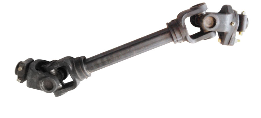

And here's a PTO shaft without shields:
