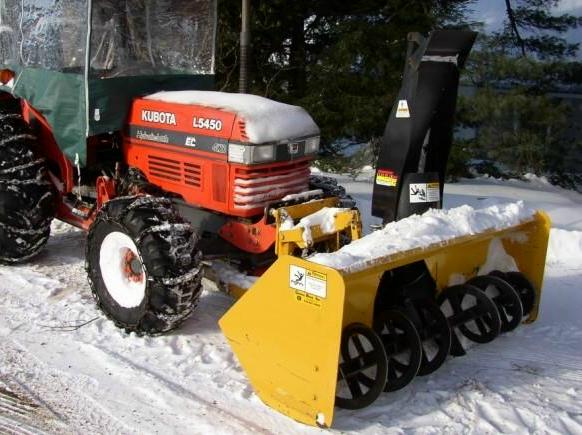

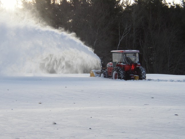

In case anyone is thinking about a front blower driven from the rear pto, there's an ad in Classifieds for my extra Erskine Snowblower. Dick B

Hi Joe, the frame and mounting points are all adjustable. Frame telescopes for length match. It could be set up to fit an M7040 - figure on a few hours getting the front plate the way you want it. As for width, the Erskine end plates are 1/4" so they're plenty strong for wings. Driving up to a garage door, etc. might leave a snow clump on the sprocket end. Wings should be fine for doing a long drive.
