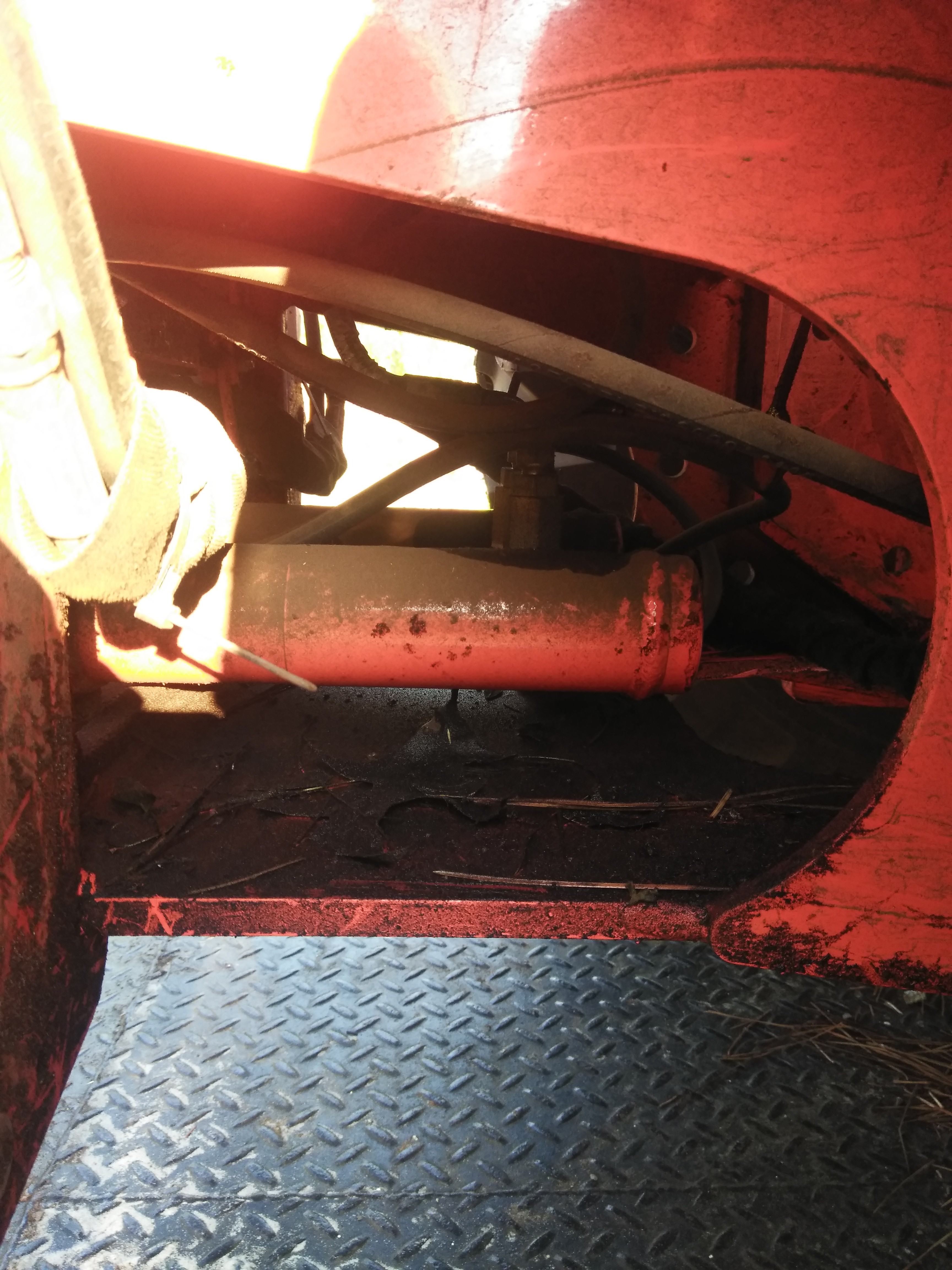

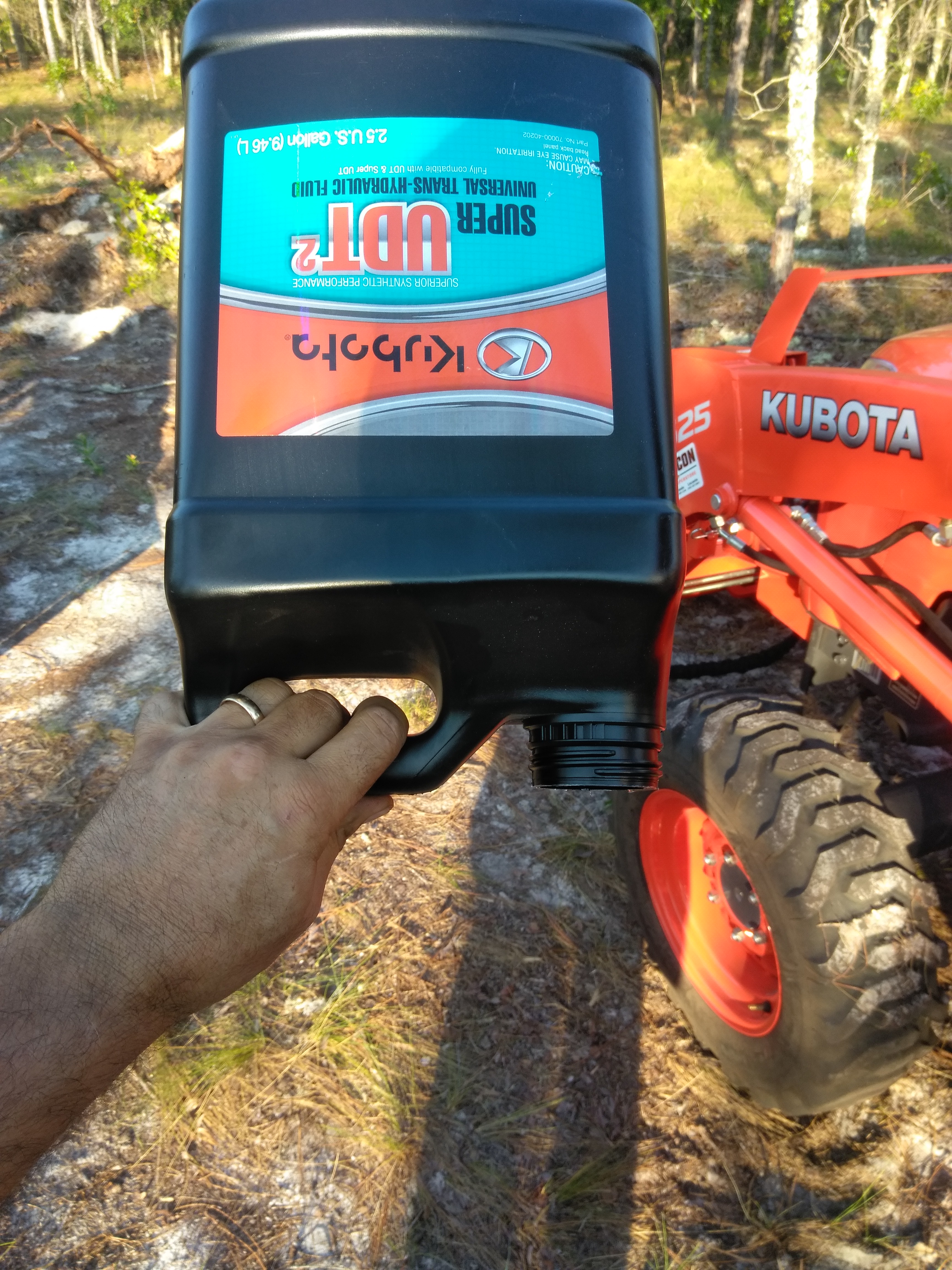

I hope thats an Ok title, spent the weekend on the property, I went there with a 2.5 glallons of Kubota trans/hydraulic fluid knowing that I needed to add some cause last weekend I had to fix a hydraulic line that had never been tightened properly underneath my backhoe.
The owners manual is confusing/a joke in my opinion so I wasnt even sure how much I had lost cause I didnt know how to check it properly.
I didnt buy the fluid from the dealer that I purchased the tractor from, I bought it locally to my home cause I wasnt sure I could get to Agricon in Ocala on Fri evening before they closed.
Anyway I did get to Agricon before they closed, bought a grease gun, mentioned to salesman and a mechanic there that the line was never tightened and I had lost some fluid but not sure how much.
They told me that if the pump wasn't squealing than I hadnt lost too much, they made no attempt to offer some fluid.......Im a bodyman mechanic, we all make mistakes......I didnt think it worth pressing anything.
Fast forward, got to my property, finally see the little tiny glass eye for fluid level, nothing showing in it at all, I dumped all 2.5 gallons in there and it came up to the 3/4 full mark eventually.
All is good.

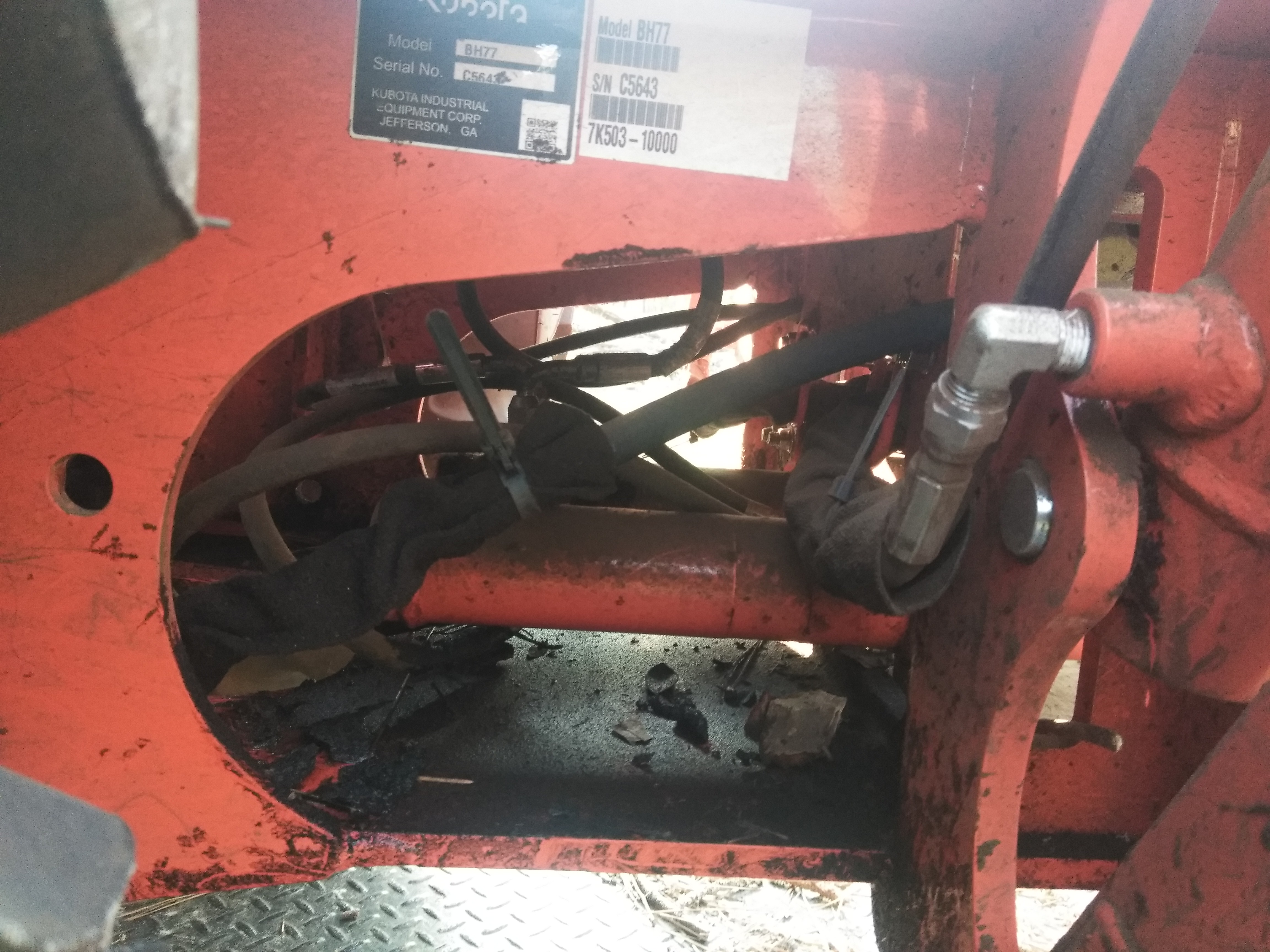

Used tractor all day and into the next and then saw it leaking again......I have no way of getting to these line unless I lower the backhoe legs into the sand and crawl underneath this thing which is very unsafe....I did it again anyway and this time found that none of the lines were tight, they were all left loose.....on mistake Im sure,,,,just forgotten.....it happens.
Now I am reading empty again, another 60 plus dollars I need to spend.
Should I ask dealer to reimburse me what I am out?
On their side they can say I should have just brought it back from the get go and let them deal with it.....on my side I dont have a trailer that I trust at the moment to haul it back ( even though its only a few miles away ) and anyway it would take to much of time that is valuable to go thru all of that.
Ive tightened them, I dont expect to have any more issues there...........teflon tape was never used.....maybe I need to correct that?
No chance they were loosened by running something over, the lines are nearly completely surrounded by thick steel

Do NOT use teflon tape on hydraulic fittings. Use teflon paste, or Loctite 5452.
