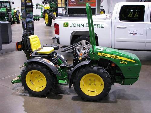

Deere does market a few speciality tractors under their brand. Mostly big AG Hi crop, Low Profile, Orchard & Vinyard. We have a 2855 at the apple orchard
At one time they sold this one under their name. It was actually made by Goldoni.

Yeah those are awesome! I'd love to have one for pulling logs! Wish Kubota would offer one! (0:
