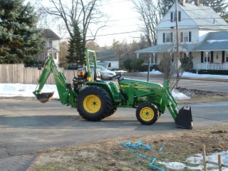

Ask how much your dealer gets for a clutch and to install it,
You should ask the dealer how much a Hydrostatic pump and the install is. I would rather pay for the clutch!!!! I own a 790 and I would put it up aginst a hydro any day doing loader work it is all in what you get used to. I use my tractor commercially every day I am not impressed with the tractor, size vs power I would not buy another. I would like to know more about the 990 and how they work size vs power. I should be fair about this it is not the tractor that I dislike it is the implaments 70 loader and the #7 hoe garbage cant say it enough garbage. Should have bought after market stuff everyone I have talked to likes them much better a lot less complaints. <font color="blue"> </font> <font color="white"> </font> <font color="blue"> </font> <font color="red"> </font>
