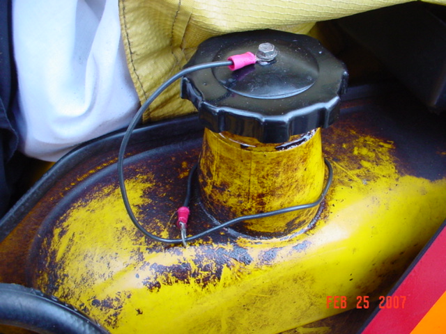

Last week I lost my dangnabit fuel cap for the second time. Never again will I forget to put it back on or whatever the heck happened to it. A simple piece of wire, 2 round terminals and a small screw is all that is needed to secure it. I did use LocTite on the screw as it is not cranked down on the wire terminal. I hope this prevents someone else from losing theirs.

I have a locking fuel cap & the key is on the same ring as my ignition key.
Don't take the key out of the cap & the cap will not be far from the tractor.

Looks like a workable solution to me. Good thinking.

Just make sure to leave airflow through a vented cap. Some engines don't seem to be set up this way, but a co-worker one time lost a cap on a JD 850 with a Yanmar 25 HP engine. To keep the fuel from spilling, he put a sandwich bag over the fill hole and rubber banded it. Sucked a 10 gallon tank (poly plastic), to the size of a football. Wound up having to replace the tank later because it would never hold more than 5 1/2 gallons, and bounced around in it's new home so much, it eventually started leaking. Sidey
