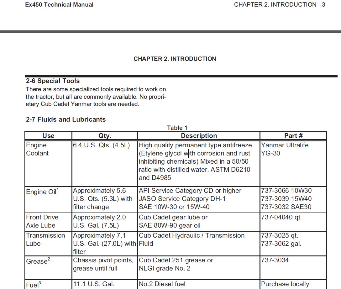

I cant find my manual for my tractor (ex450). I want to do the 500hr service. I need the kind and quantity of oil for the front axle and hydraulics. Anyone have a ex450 service manual handy?

Yep, I had found that manual online.
The EX450 takes approximately 2.0 gallons of SAE 80W-90 gear oil.
