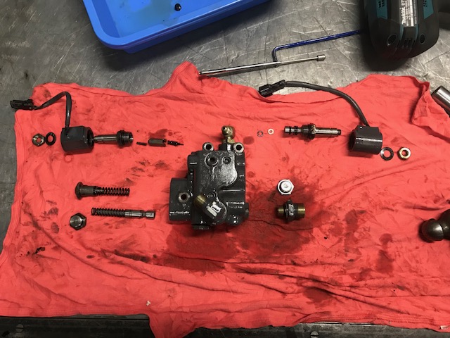

ok some news,
i tested with pressure gauge today and no pressure at all from the 4wd port - two days ago i had some flow but none today, tractor still has some steering so i dont think the hyd pump is at fault.

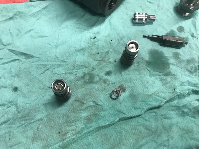

so i removed the modulating valve and stripped it down slowly and bagged each valve assembly as some of the springs are very similar.
when i removed the 4WD solenoid valve i found what i hope is the problem. The screen mesh, washer and cir clip were floating around inside the housing.
the reducing valve was hard to remove as the washer etc has been hitting it and caused burrs - i hope i can clean it up to reuse.
when i look at the method Daedong have used to hold the screen in place is a bit of a joke, the groove that the cir clip should sit in and be retained would be lucky to be only .002" deep. i checked the pto valve and it is the same and to top it off they have put the cir clip upside down ( the sharp edge of the cir clip should face out to help it from poping out.
so i intend to see if it all cleans up ok and i will try and deepen the groove in the lathe.
i hope this may help others if it happens again, i hope it works again as a new valve is around $1700.00 AUD IMG_9405.jpgIMG_9398.jpg

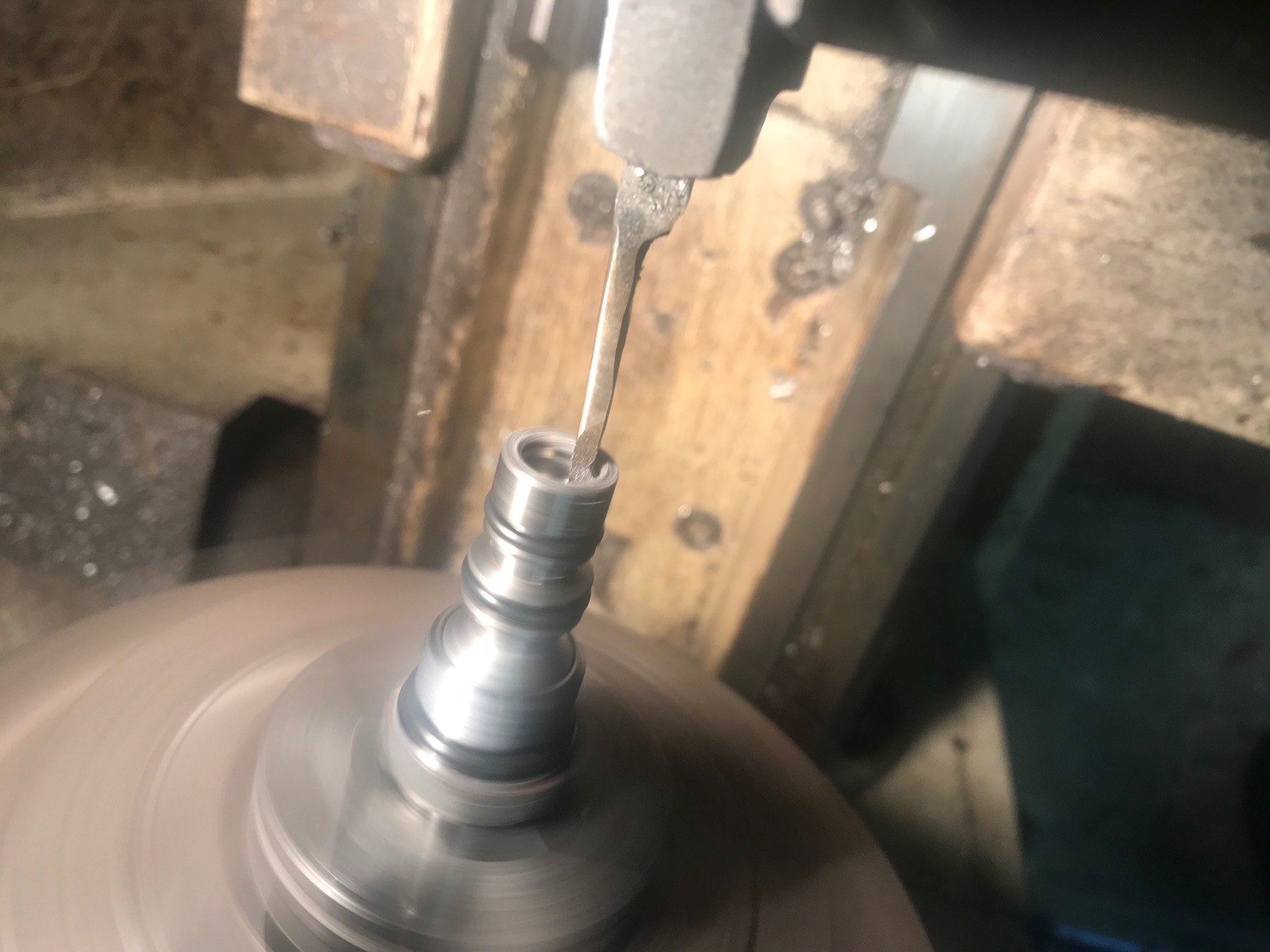

so i machined a deeper groove into the solenoid valve to keep the cir clip in place on both the pto and 4wd valves.
spent around two hours carefully cleaning up the damaged spools, and hand lapping and all went back together well,
put it back on tractor and everything work again and steering is better also.
so i guess the steering oil was being lost via the drain on the 4wd solenoid
