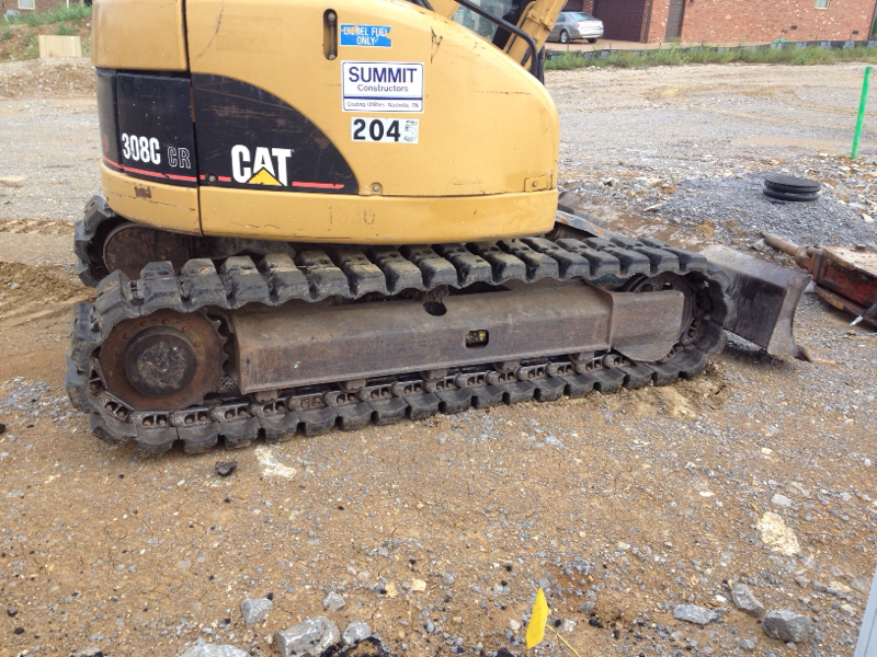

This is what we run on ours. They seem to hold up pretty good. Our guys are hard in them, we have a lot if rock here so it's on everything from dirt to pavement / concrete and shot rock. Don't know the brand though.
   / Excavator track options #14
The crews like it. It is pretty old so its a not as fast and as powerful as it once was but it gets the job done. The 308 and 303 we have stay busy, there is always a small spot we need to get into. We are trying to talk the bosses into getting a 305 to fill that size gap and get an extra machine.
