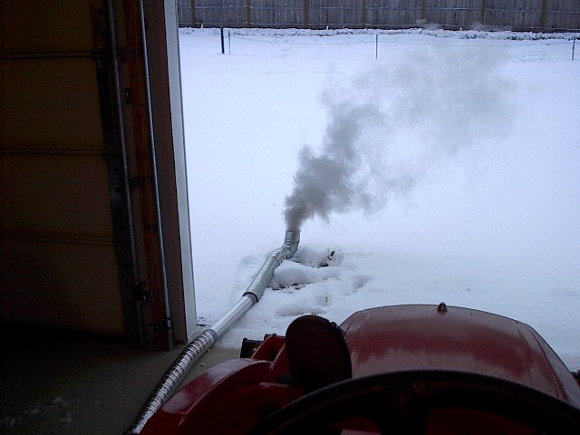

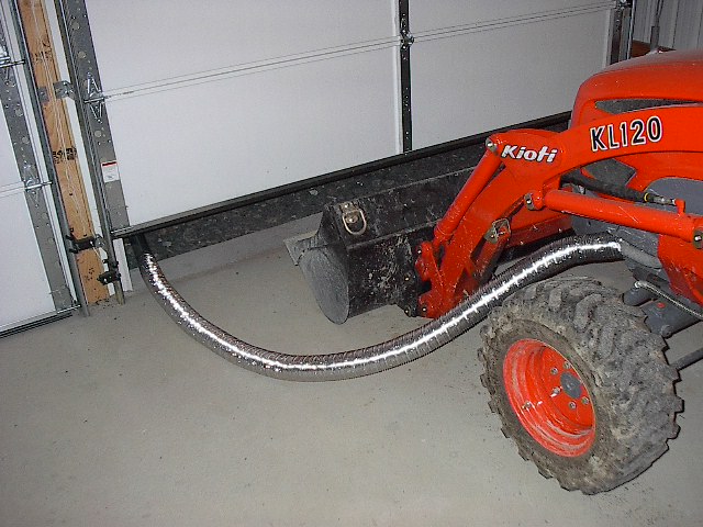

I would like to have a quick attach hose to attach to my JD 3720 exhaust when I back it into my under house garage for winter storage to eliminate stinking the whole house up with diesel fumes. It would need to be only 8 to 10' long. What is used ? I am open to suggestions.

Just ran my NH 40 hp Boomer for several days inside my garage (door open) and fed the exhaust outside using two parts. Lost electric power in a thunderstorm and had to use the PTO generator. Right at the tractor, started with a flexible piece of stainless steel exhaust, about 8 ft long and connected with a muffler clamp to the tractor, which has a low exhaust by the front wheel. Had to slit the end of the flex pipe to fit in the clamp since the smallest flex I could find was 1-3/4". Second, I simply slipped this flex exhaust inside a standard piece of aluminum rain-gutter downspout, so I end up being able to duct the exhaust about 14 - 15' away. Works like a charm, but the pipes get pretty hot. Watch out if your just going to lay them on you lawn.
   / Exhaust Extension to Eliminate Indoor Fumes #4
This is what I did. (See attachment)

   / Exhaust Extension to Eliminate Indoor Fumes #5
Another.
GerardC,
Looks like you are using dryer duct? Is that correct or is it something else?
Shooter
   / Exhaust Extension to Eliminate Indoor Fumes #8
<font color="blue"> Looks like you are using dryer duct? Is that correct ....</font>
Yes.
