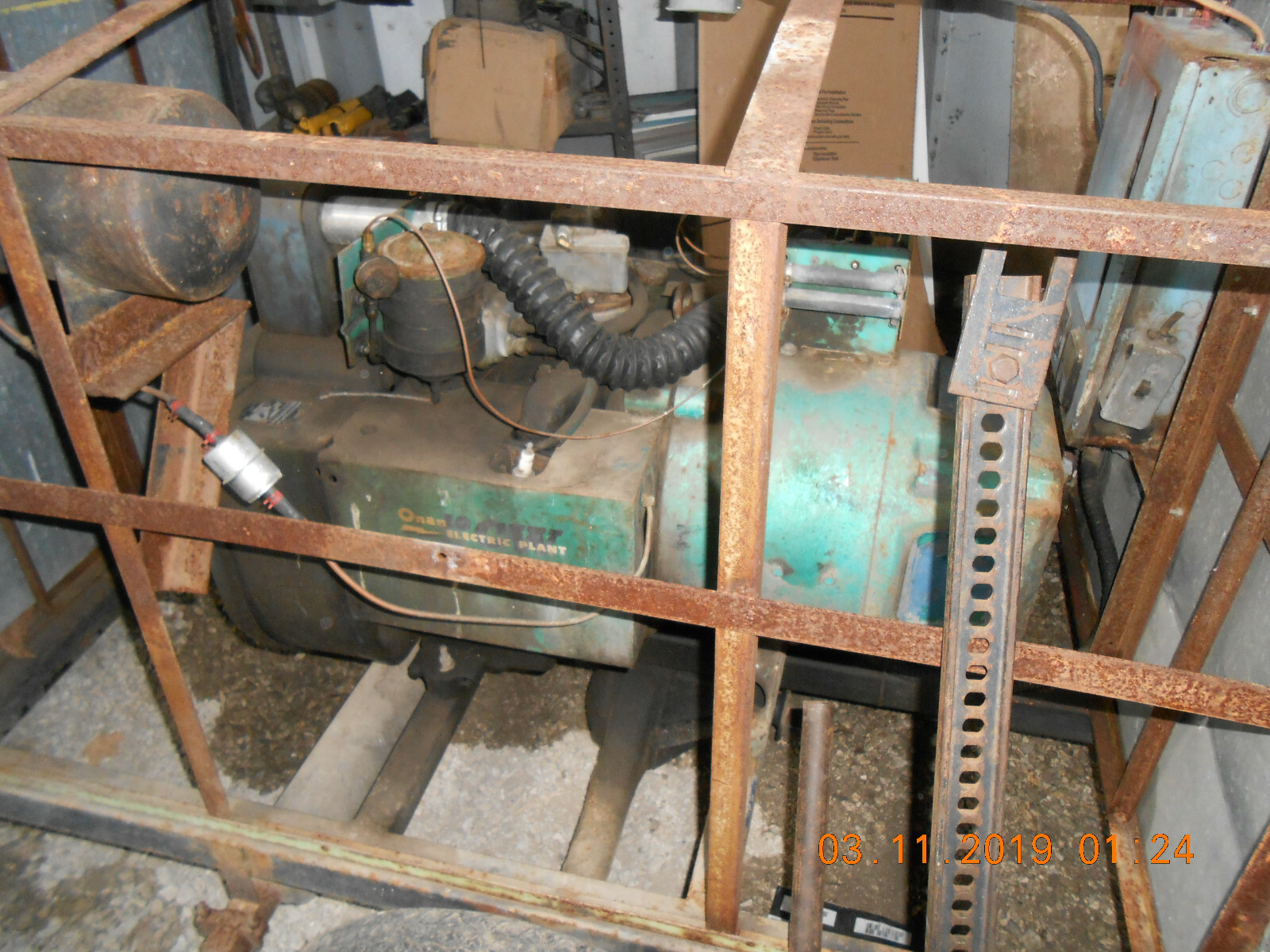

explain this too me
   / explain this too me #2
It appears to be a “generator head”. It would need an engine of some sort to become a useable generator set.
It appears to be a å*µenerator head? It would need an engine of some sort to become a useable generator set.
I agree, I dont understand why a better description cant be included with the listing. There are several of these on E-bay with different sellers. All non descriptive listing.
Thanks
   / explain this too me #4
Thanks
Probably none of the sellers are sure what they have. Might have just copied another listing.
I contacted 3 different sellers and no response from any
   / explain this too me #6
It's an ONAN generator with flathead ONAN motor, could be a CCK model engine.
   / explain this too me #7
ONAN generator probably gasoline for fuel.. In first one or two pics you can actually see a sparkplug on square block area on left side (engine) of generator....
Looks to be almost complete but that is not saying much...
What would bother me is statement "its stuck and air cleaner is missing and may have sat outside" that could mean rain has entered intake and gone down and maybe rusting rings to cylinder or some other dreadful thing... At best you may get it to run at worst full overhaul...A $65 dollar bid could easily turn into a $1000 rebuild....
