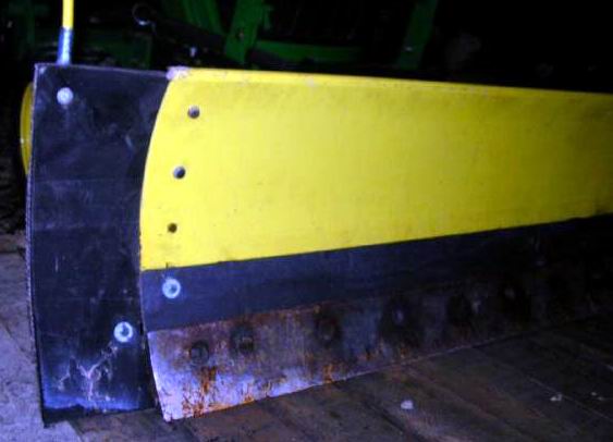

First chance to plow any snow since I added 6" to both sides of my 54" front blade
We received about 10-12" Tues night and then doing the day picked up another 6-8 " .Even being a lite snow , very dry, could find no fault in lack of power or steering
Yes you always have the front tire slide going on a slope but I don't think it was any worse than when the blade was new.
I did like the fact with the extra width ,the pushed snow didn't come right back where you had just plowed ,Yes you still have some but I don't think near as much.
Haven't had a chance to take photos of this extra width
I will try and get some this weekend and post them

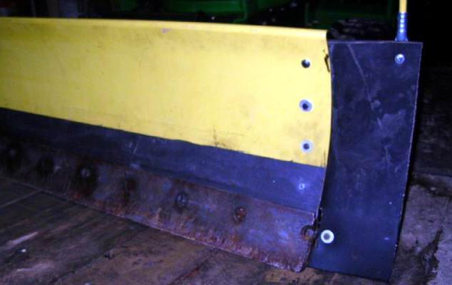

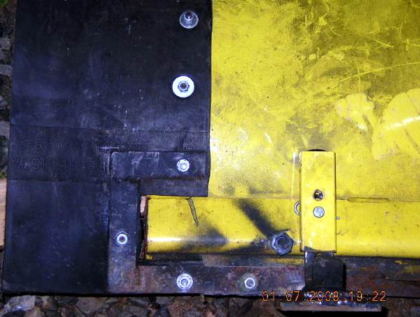

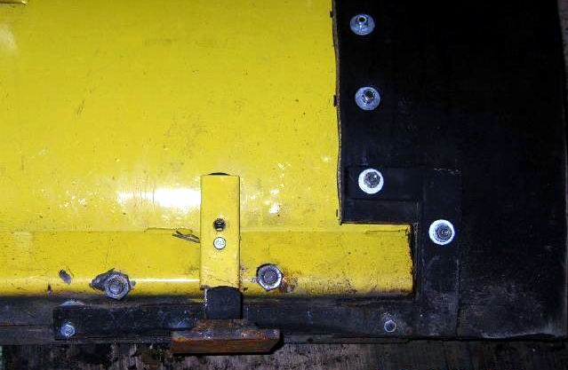

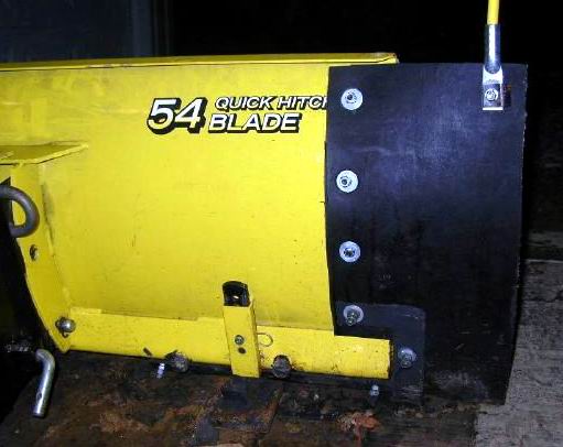

   / extensions on front blade
Have some photos of blade extension and
Hope you can tell how and what I did
1st photo front R side
2 photo fornt l side
3rd photo back
4th photo back bolted and metal backing
5 another shot of back
