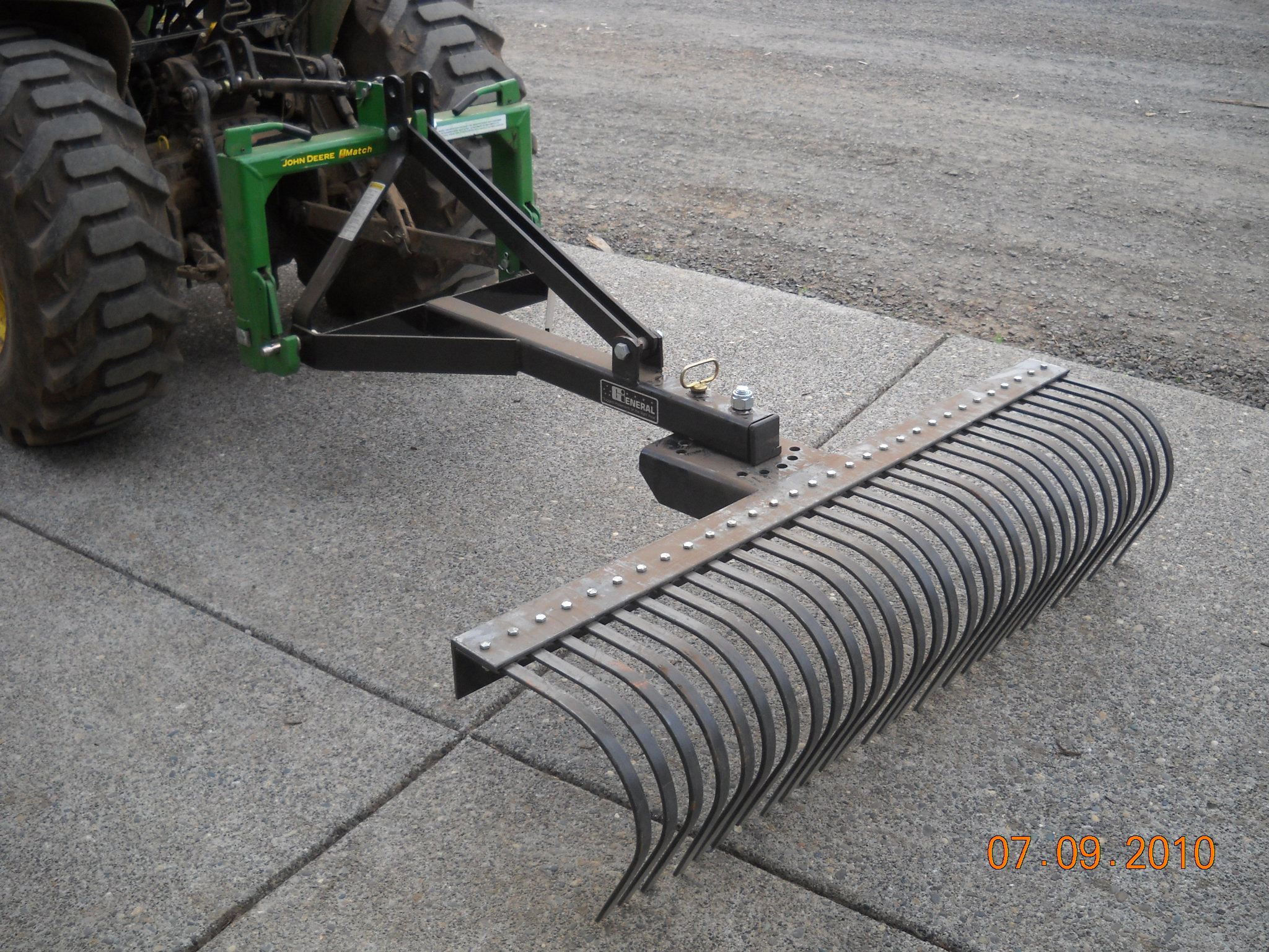

There are some parts of my gravel drive, where it seems like the rake just gets pushed up so it skids along the surface. I wonder if adding some weight to the landscape rake would help. What do you think? Good idea, or does it work against the springiness of the tines?

It may help some, however, you may have broken tines in your future. Have you changed the length of your toplink to make the rake more or less agressive? Ken Sweet

make sure the top link is in it's shortest position to get more dig.

Try your top link in different positions....short and long. Go Slow.
Another thing to try is do the work in the rain or when the ground is damp or even wet. (not muddy) Gravel in particular is much easier to work when it has rained.
Also, I prefer a rear blade to get my gravel driveway the way I like it. It digs better. Dirt or loam I prefer a rake.

Weight should help - not sure if the top link angle will do much until it get's loaded up. What I've found makes a big difference is ANGLING the rake. Putting an angle on it will help it to dig as the tines take on a bit of a 'plowing' function.
Lastly, you'll probably also find, as many others have stated here and on other "rake" threads, that the rake works best after a rain or in the spring when there's more moisture in the ground.

yes. Having it in the shortest position will make it dig better since there is more of an angle to the tines/blade. Lengthening it will make a less agressive pass. It is like a boxblade, shorten the toplink for more pressure on the scarfier teeth and the cutting edge. Lengthen it and it will have more of a back blading effect to the ground where there is more "grade" rather than dig. You can see in my picture of my rake, the top link is about 1/4 from being in the shortest position. If it were shorter, there would be more dig due to the greater angle on the tines.
