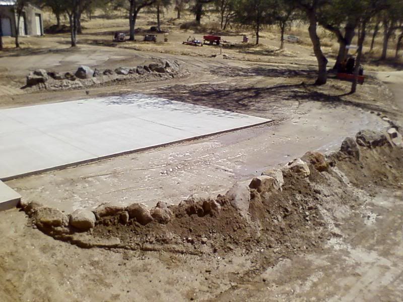

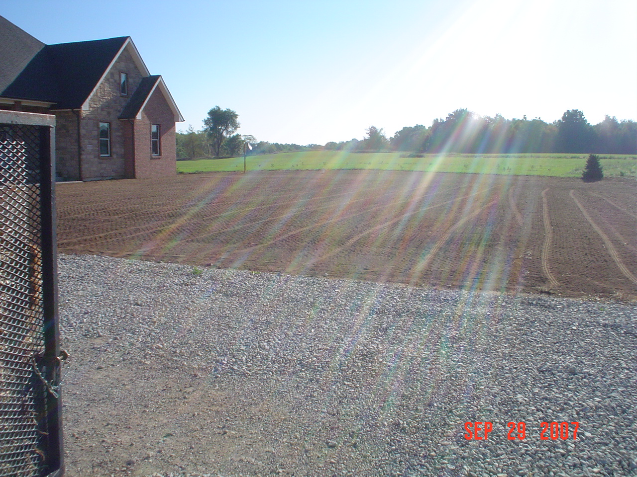

Do you have it "roughed in" to where it's close but not perfect yet?
If there are high and low spots, there's no reason you couldn't cut the high spots only to fill in the low ones. Or bring more dirt if there isn't enough to fill the low spots. You might even have to cut in reverse like a bulldozer, using the rear of the boxblade to knock off some high spots. Be careful not to bend your drag links using that method. Once you get it acceptable, tilt the boxblade back so it smooths with the rear blade. I would use the landscape rake or drag harrow after I got it level, and that is only to get it soft for seeding...to mix in loan, compost or topdressing.
I've done a number of projects like that...all without gauge wheels. Some were large and some smaller, but they all turned out really flat and smooth that way. The first photo is of a couple small areas I just did last week, getting ready for planting grass like you. The others are from when I was building my barn pad. You can actually see the barn in that first photo in the top left corner. That pad was about 80' x100', so it can be done with a little patience and effort. Just stay after it and get really good with those implements.
