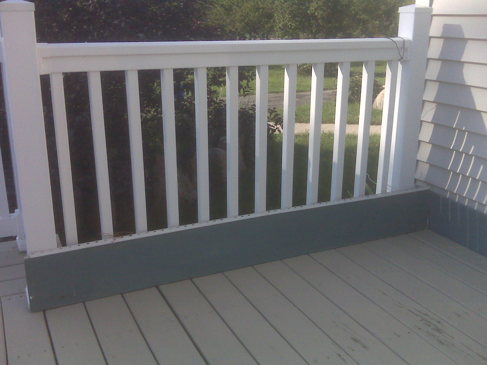

I am in the process of sanding and staining a huge deck, it has white PVC railing, and both those and the light colored house siding are a PIB to clean if I splatter stain on them. Saved about a dozen straight sections of old aluminum siding and powerwashed them well, and to install 30 feet of splatter screen on the house and rail section took 5 minutes. You can use the holes punched in the top of the siding to secure it with wire or ties.
Works SO much better than masking tape, paper, or cardboard...it's also weatherproof.
