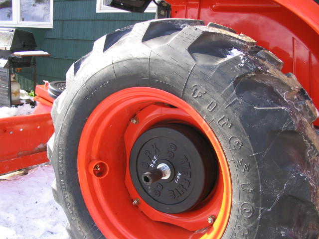

Hi...
Have 'em on my Kubota... see attachment here and next post too...
If the web site dosen't specify all the info. needed to order... call 'em and find out...
I have (3) 50 pound barbell weights on each rear wheel... Easy to put on and off... where some manufacturer's weights are difficult to do...
The threaded rod stays on when the weights are off...
I like 'em...

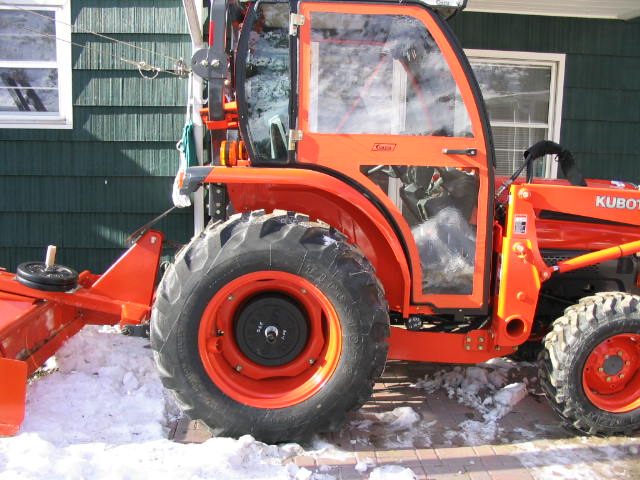

Another picture...
Put 2 extra weights on the grader blade when needed...

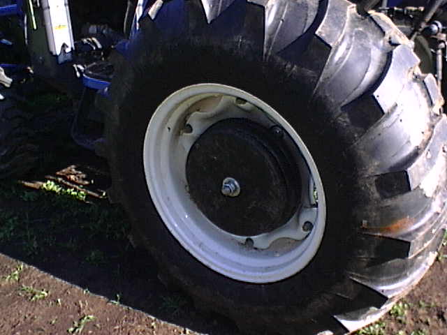

They're great - 5 stars! I have 8 x 50lb plates on the rear. Much easier to get on and off that factory weight and much less expensive. Absolutely no problems.
