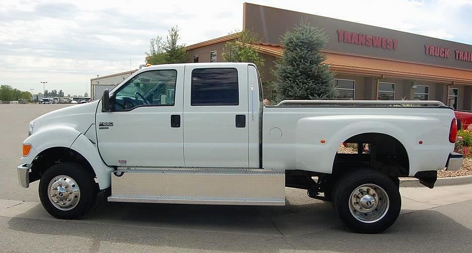

   / F-550 Pickup #6
   / F-550 Pickup #7
Interesting truck. Too bad that engine / trans isn't in the F250 / F350 line:
6.7 Cummins, Allison auto, 5-SPD, 325HP, Diesel,
as shown in the link. Is this a complete one-off custom or do F650's come with Cummins?
   / F-550 Pickup #8
F650 come with cummins. I think you could also spec a 3126 cat, or something similar, and maybe the vt365 (6.0) in newer models. or dt444(7.3) or dt466e in late 90's early 2k models. I haven't paid much attention to them in several years, so some of my info my be incorrect.
   / F-550 Pickup #9
The F-450 pickup has the same WB as a F-350, 172.4" for a crewcab, while a F-450 chassis cab has a WB of 176.2" for a crewcab.That gives it the industry standard 60" cab to axle for aftermarket bodies. It would take some finagling to fit a dually bed to a chassis cab truck.
I've read, as mentioned above, that Ford has "dumbed down" the 2011 F-450 pickups to be a heavy F-350. Lighter GVW than before and 17" wheels instead of the 19.5" of the chassis cab.
   / F-550 Pickup #10
That is why the SRW bed fits better from what I have heard. You can scoot it forward the needed amount and then put on the fender flares for the dually to make it look right. The main issue is the raising of the cab to get the body lines matched up due to the larger "hump" over the rear wheels.
