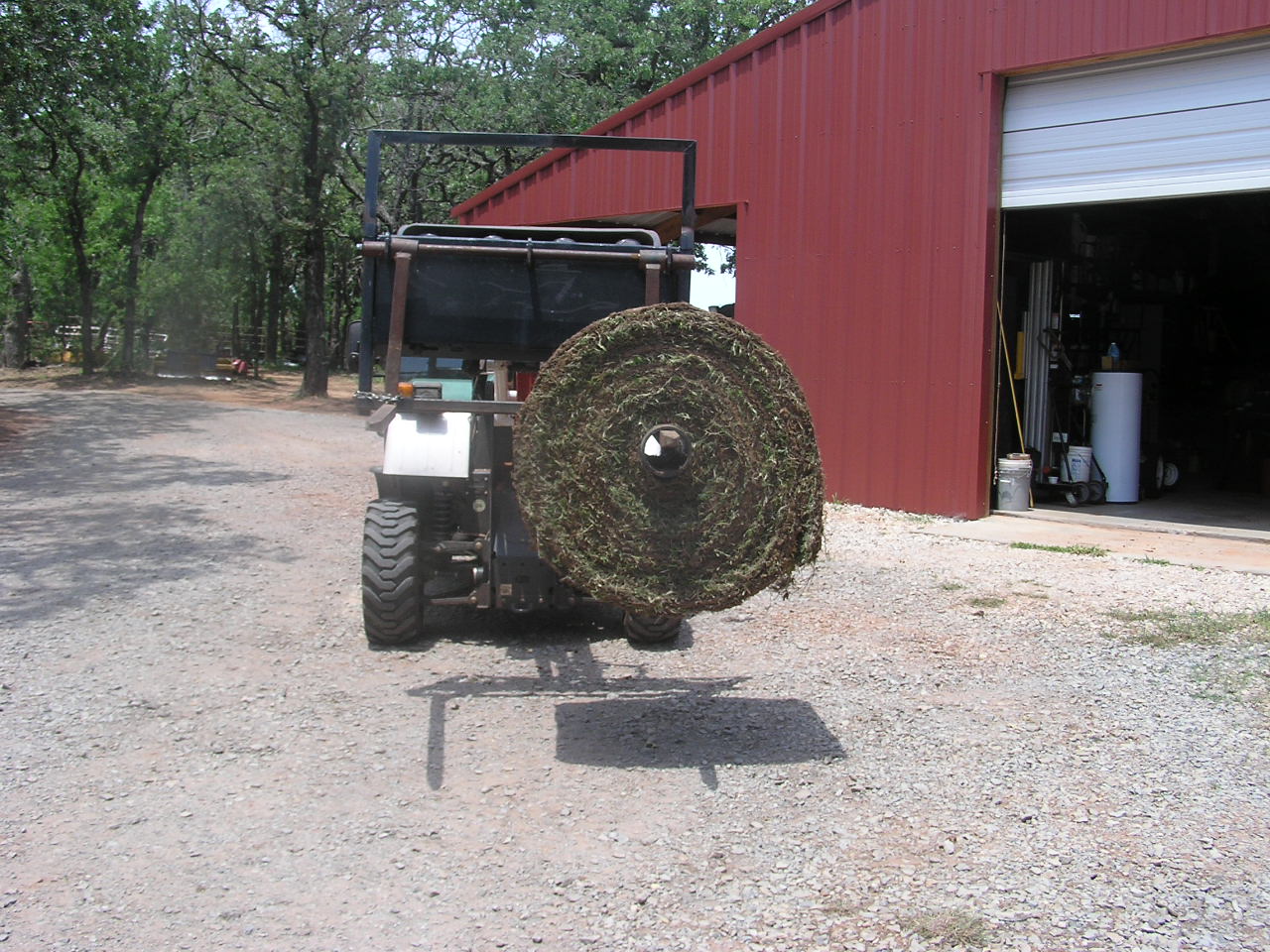

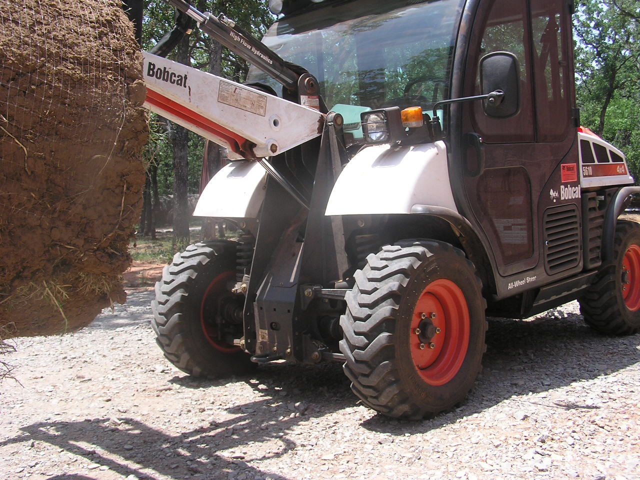

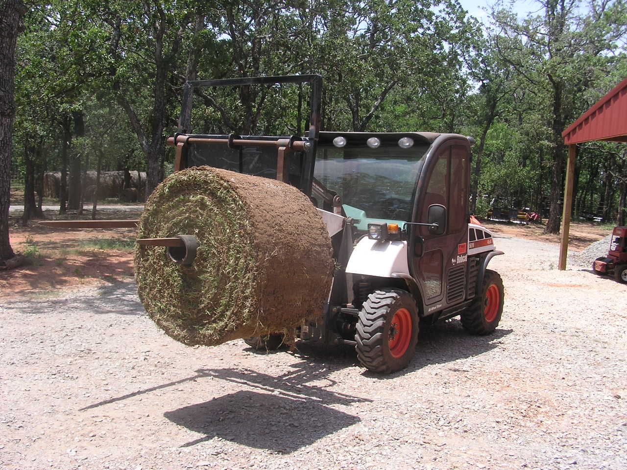

Is your 5600 still leaning?
My 5610 started leaning to the left yesterday! :eek: :D
But not much.
   / F series leaning
But not much.
View attachment 382169 View attachment 382170
Yes it is! I still have to get it to the shop. I bought the chipper for it and though it's rated for it, it leans hard to the right when the chipper is on. The chipper is probably heavier on the right when the feed table is on the right side but it will lean with any heavy attachment even if it's slight.
I plan on getting it into Bobcat soon. It's only got 100 and something hours on it.. and no hard use so I doubt anything is bent/twisted. I noticed some of the bolts that hold the suspension are mounted different on each side.. don't see how that could be an issue but I think someone goofed at the factory. Maybe I have a weak spring..
Keep us posted on what you find...
After looking at your pics again, that's what mine does when the weight isn't centered..
