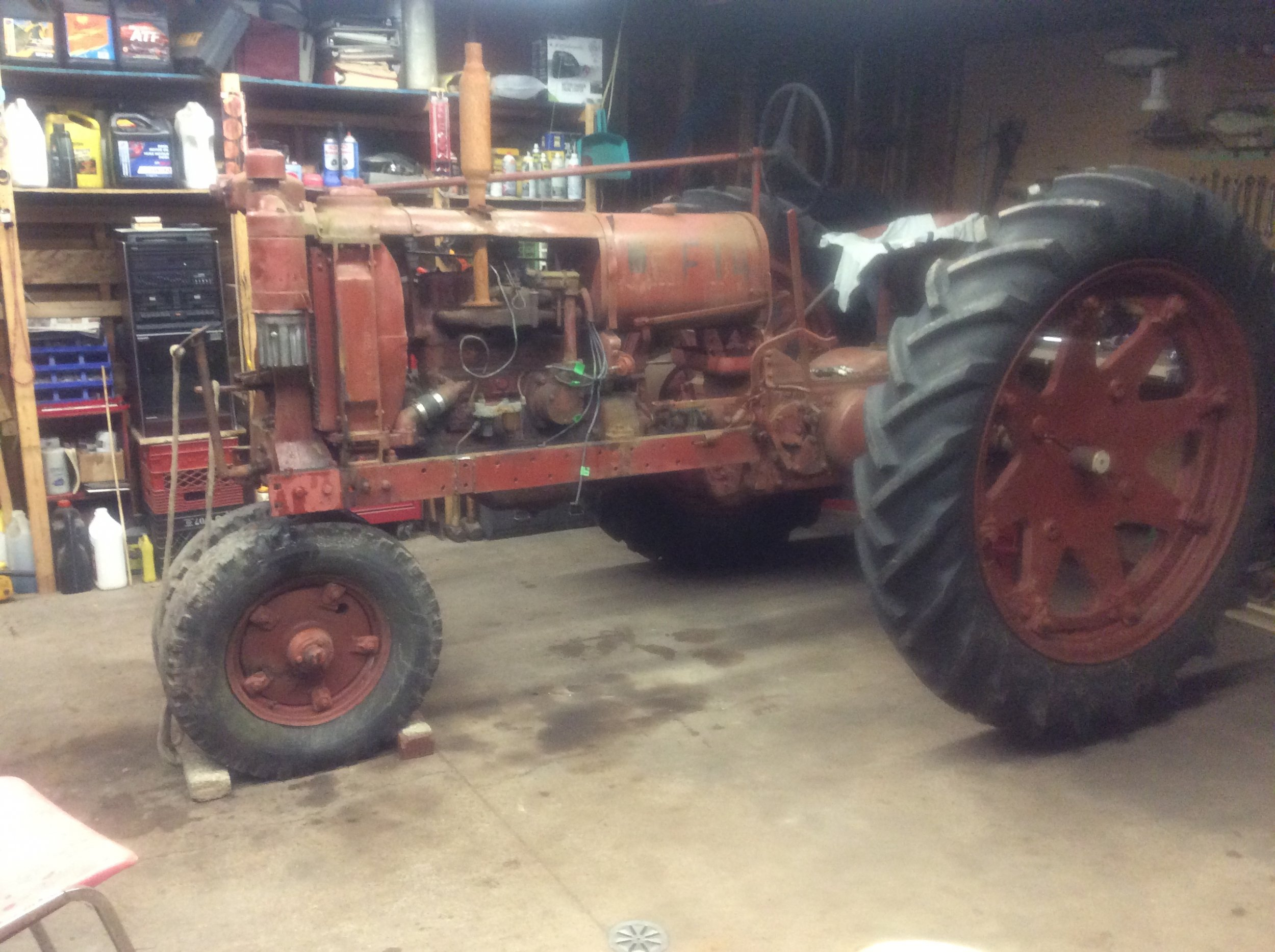

I have a F14 Tractor and would like to know how to move the rear wheels in or out?
I removed all the bolts but how to remove the keys?
Sure could use some help with this.
Pappy
   / F14 Tractor #2
It's been almost 50 years, but I believe you need to punch out (2?) Woodruff Keys per wheel. They are half moon shaped, and are force fitted into a slot in the axle. Use a center punch to either rock it out, or get underneath one end and tap up. It doesn't take much if not seized.
   / F14 Tractor
   / F14 Tractor
Thanks I will try and remove the keys
   / F14 Tractor #5
I’ve removed woodruff keys by clamping on it with a small vise and prying with a screwdriver.
