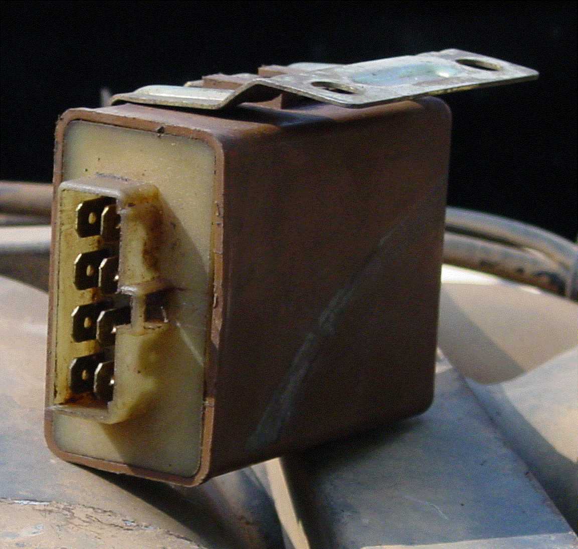

Tractor Ernie or anyone familiar with the F235. I've been having intermittent starting problems, but now won't fire at all.
When I turn the key right to 1st stop, I get a click, then when I turn key to start, the engine turns over, but it won't fire.
I noticed before when it was intermittent, that along with the click I also heard a series of approx. 3 sounds and when that happened and I turned to start it fired right up.
I checked all the wiring I could locate and checked the fuses. The far left 5amp fuse was blown. I replaced it. I had the battery checked and was advised it had a bad cell. I replaced it today.
It still clicks once, but won't fire.
I attached a picture of a control I can't identify. Can you tell me what it controls and could it be bad & causing this problem? The voltage reg is a sealed unit. Can it cause this kind of problem?
From my questions I know you can tell I'm no mechanic. Can someone point me in the right directions.

The F series tractors have a fuel shutoff switch on the right side, between the fuel filter and the engine block
It's the little motor that makes a winding noise when you turn the key on & off.
Do you still hear the winding noise?
If not, MAYBE your fuel shutoff switch went to heaven.
The first click that you hear is the glow plug timer switch.
Please let us know if the shutoff switch still works.

Not a starter solenoid . A fuel shut off solenoid yes. Sounds like problem lies in the fuel shut off circuit.

Thanks Ernie, You're up early, since it's only 8am on the East Coast.
I think I found it. Does it have a little lever on the side? No, I don't hear it attempting to operate. The whirling sound you mention was probably what I was hearing after the chick.
I just ordered a starter solenoid from Hoye. I'll try to cancel that and switch it to a fuel solenoid if you think that is what the problem is.
You've always been a life saver for many of us F series owners.
