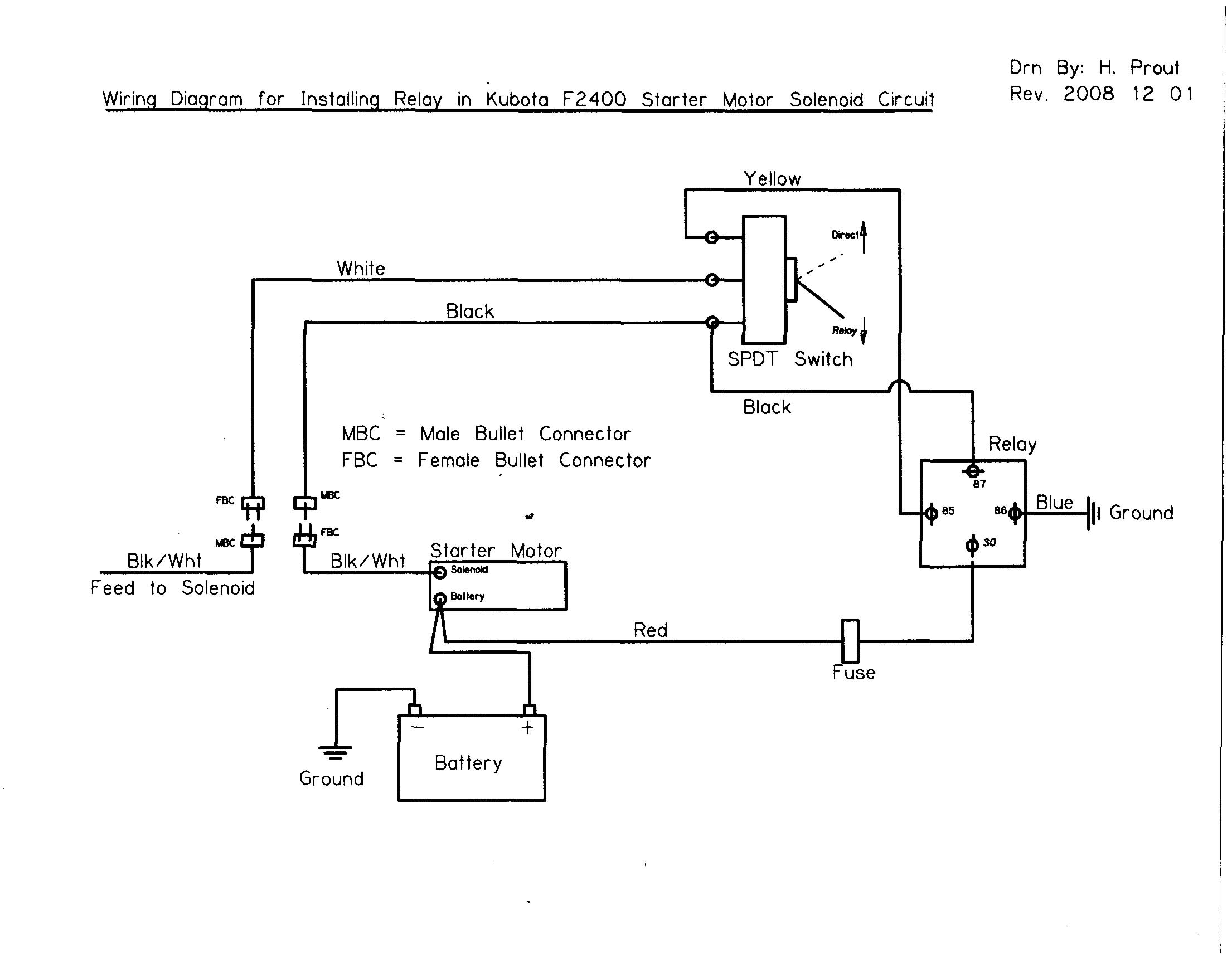

Over the past year of so my F2400 (basically a B2400 turned around to go the other way)has been developing an increasingly frequent starting problem. Initially it occured once in a while but lately it has become more like once every two or three times when I try to start the tractor. When I turn the key to the start position, the starter solenoid clicks but the starter motor does not turn. Sometimes if I turn the key on and off a few times it will kick in, other times it won't. Sometimes if I leave it for a while and come back it will start. I know it is not a safety switch because the solenoid clicks - it doesn't do so if a safety switch is open. The instrument panel and ignition switch are on the right fender, and although there is a splash panel, the wiring is subjected to water, mud, salt, etc. - ideal conditons for corrosion.
I have replaced the battery and battery cables. I had the starter motor checked. They put a new plunger in the solenoid but otherwise it was OK. I subsequently had it rechecked - they say I must have a low voltage supply problem to the solenoid and that the plunger is not fully engaging. When it doesn't start on its own, it will start right up if I briefly put a charger on the battery - which supports the low voltage theory. Before I do anything more, I will use a voltmeter to check the voltage going to the solenoid. If it varies then I know I have a conneciton problem.
I suspect I have a bad connection somewhere between the starter switch and the solenoid - possibly even a worn out starter switch. The old girl is nearly 20 years old and has several thousand hours on it. There are three multicircuit disconnects between the starter switch and the solenoid. I am somewhat afraid to open these up as in doing so, I may destroy the connector blocks. This happened yesterday when I mistakenly opened another connector block. It was badly corroded to the point that some of the connectors broke off or came out of the blocks. I found that some of the trailer wiring harnesses have six lead connector blocks and I was able to spice a male and female pair of these into the circuits to replace the original multicircuit connector terminals.
Does anybody have any other thoughts as to possible causes of this problem?

Thanks for the tip LQPAPPY. I started thinking about what might be in the Kubota kit when it struck me that a simple relay should work - use the feed from the wiring harness to energize the relay to feed the solenoid directly from the battery. The neat aspect of this is that it keeps all the safety switches in play. I'll check out the Kubota kit but I'll bet I can rig a relay much cheaper - especially since I think I already have one left over from a fog light kit. Thanks again.
   / F2400 Starting Problem
I contacted the local Kubota dealer this morning and they are not aware of any kit from Kubota to deal with low voltage to the starter solenoid. BUT they did say that when they run across this problem (and it sounds as though it is fairly common) they put a relay in the circuit from the starter switch to the solenoid so that the solenoid gets full battery voltage. I found a couple of Bosch relays amonst my electrical bits and pieces so I will install one and see if it solves the problem. Once again, thanks for the tip.

Now that I know what to look for, I have tried repeatedly to get the problem to recur. So far it hasn't - but when it does, I will check to voltage going to the solendoid, and if it less than 12V, I will install a relay in accordance with the attached diagram. I have the wiring harness ready to go - all I have to do to install it is cut the feed line to the solenoid, crimp on the bullet connectors, connect the wires to their appropraite terminals and, attached the bracket for the relay and switch to the firewall. The bullet connectors will give me the flexibility to quickly remove the relay harness should I want to do so sometime in the future. I included a switch in the harness so that I can operate in normal mode unless there is a problem. Then a quick flick of the switch and the relay circuit will activated. I had a Bosch relay and socket from a fog light application in my electrical spare parts bin so used it. Similar relay and socket sets are available at more auto parts stores for less than $10 - the local Kubota dealer wanted $40 for just the relay! Once again, thanks for the many helpful suggestions.
