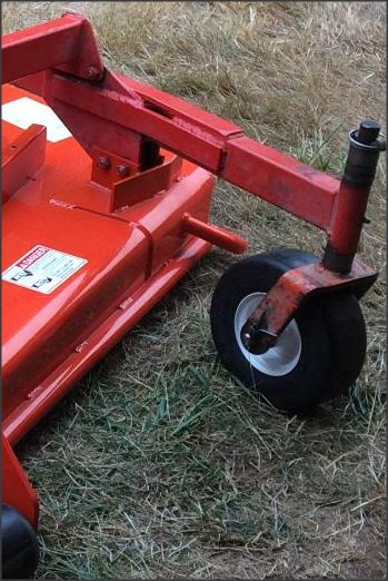

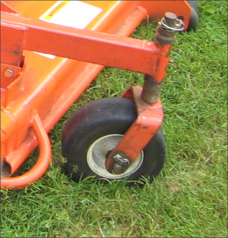

Just replaced one of the deck wheels tubes. Made it one mowing. All the tires that show up on a search have a 5/8" bore. Not sure if I can swap the oem wheels to the aftermarket to make it all work. Anyone have suggestions. They're not cheap.
   / F3680 solid front tires #2
5/8" is a pretty common axle size. Get the outside diameter of your wheels and thickness at the axle. You may be able to get wheels with solid tires for cheap at Harbor Freight. You could also try filling them with foam making them a semi solid wheel.
Is F3680 using 3/4" gauge wheel axles?
I use Carlisle solid rubber gauge wheels in my F3060 and they work good.
The mower was fitted with Marathon brand solid rubber wheels when I bought it few years ago.
The gauge wheel axles are smooth 3/4" water hard drill rod which can be purchased 36" long and cut to proper length - both ends need 3/16" holes for cotter pins.
Replacement solid rubber tires & bearings were also pretty easy to find on the eBay.
