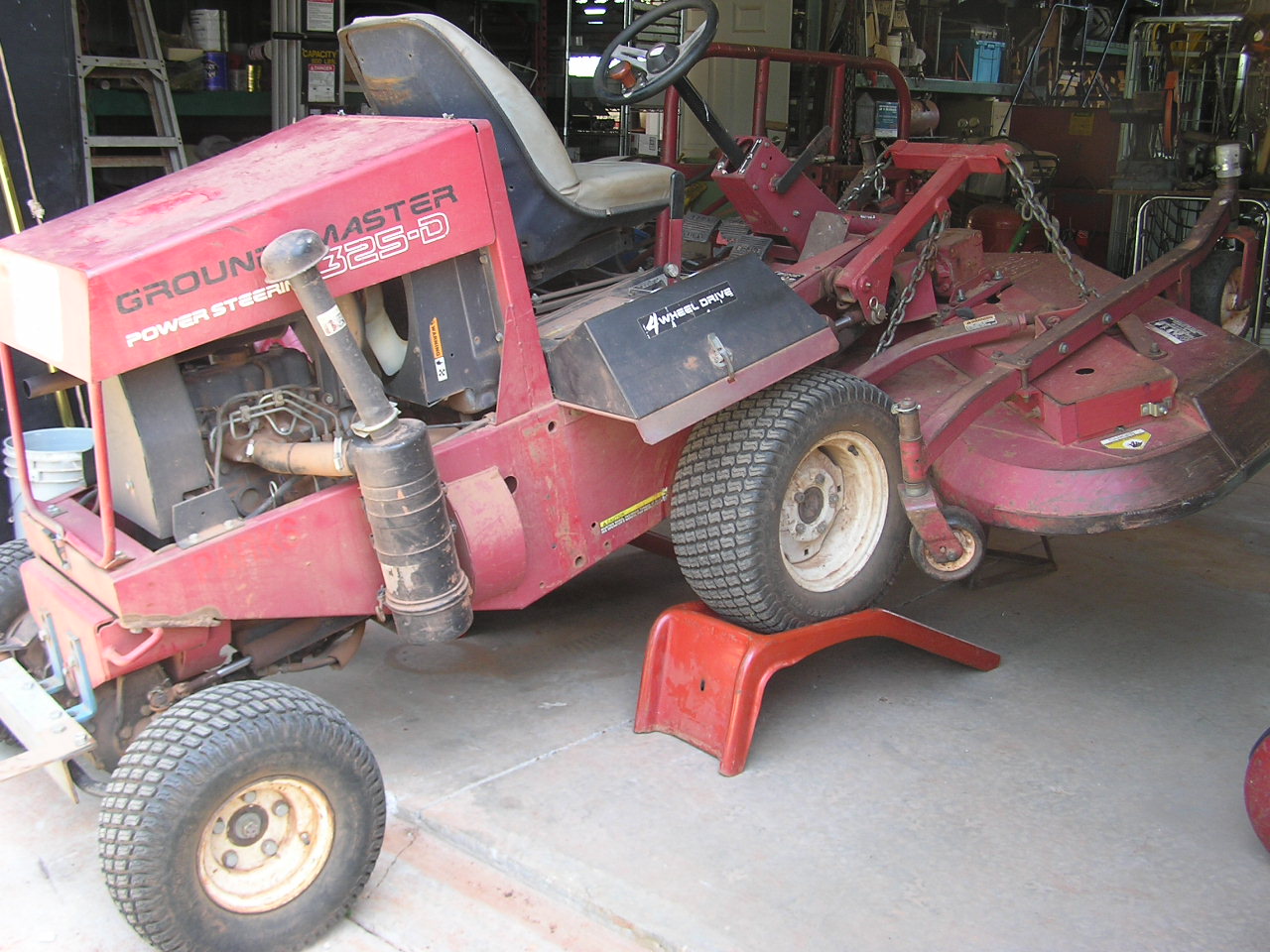

Had this for a gear, never tried it. Thought I'd tilt up and sharpen blades before start of mowing season.
Pretty sure I've followed instructions but it won't tilt. I even put a cheater pipe on it for leverage bent the pipe.
Maybe I'm seeing the facts an old man must face. Ideas anyone?
   / F3680 tilting up 72" deck
#2
Drove F3680 up on ramps to get blades off and it hit me what was wrong. I hadn't lifted the deck with hydraulics. But actually doing it the way i did worked pretty good.
   / F3680 tilting up 72" deck #3
Yep, I use ramps because the deck doesn't tilt. :(
   / F3680 tilting up 72" deck #4
I've tilted mine several times over the years and one time I forgot to lift it to max with hyd before physically lifting and met the same resistance.:confused::eek::confused3::confused2::D
