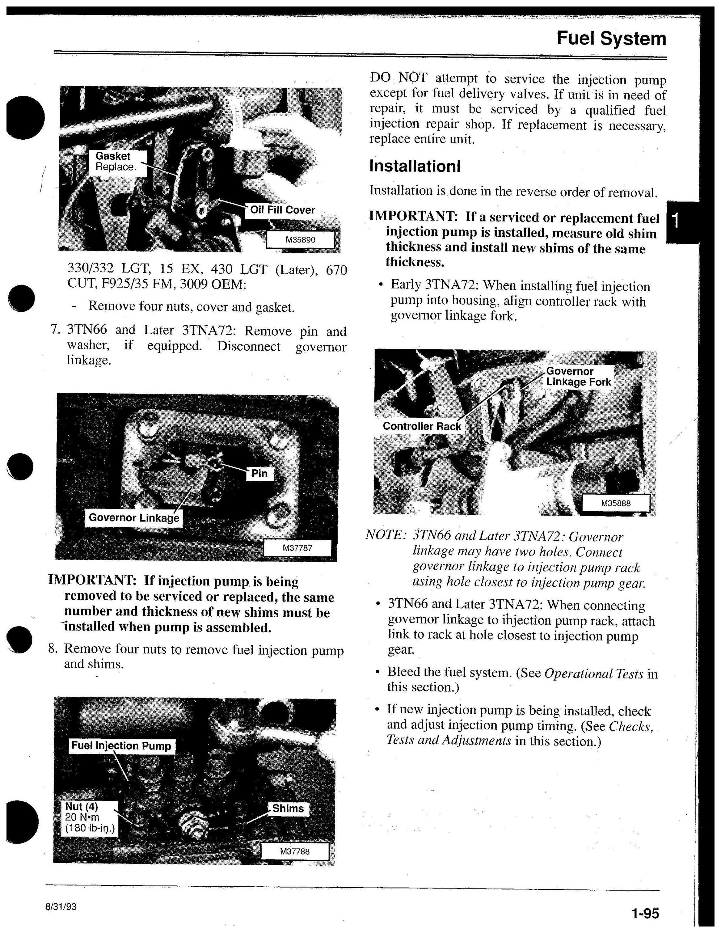

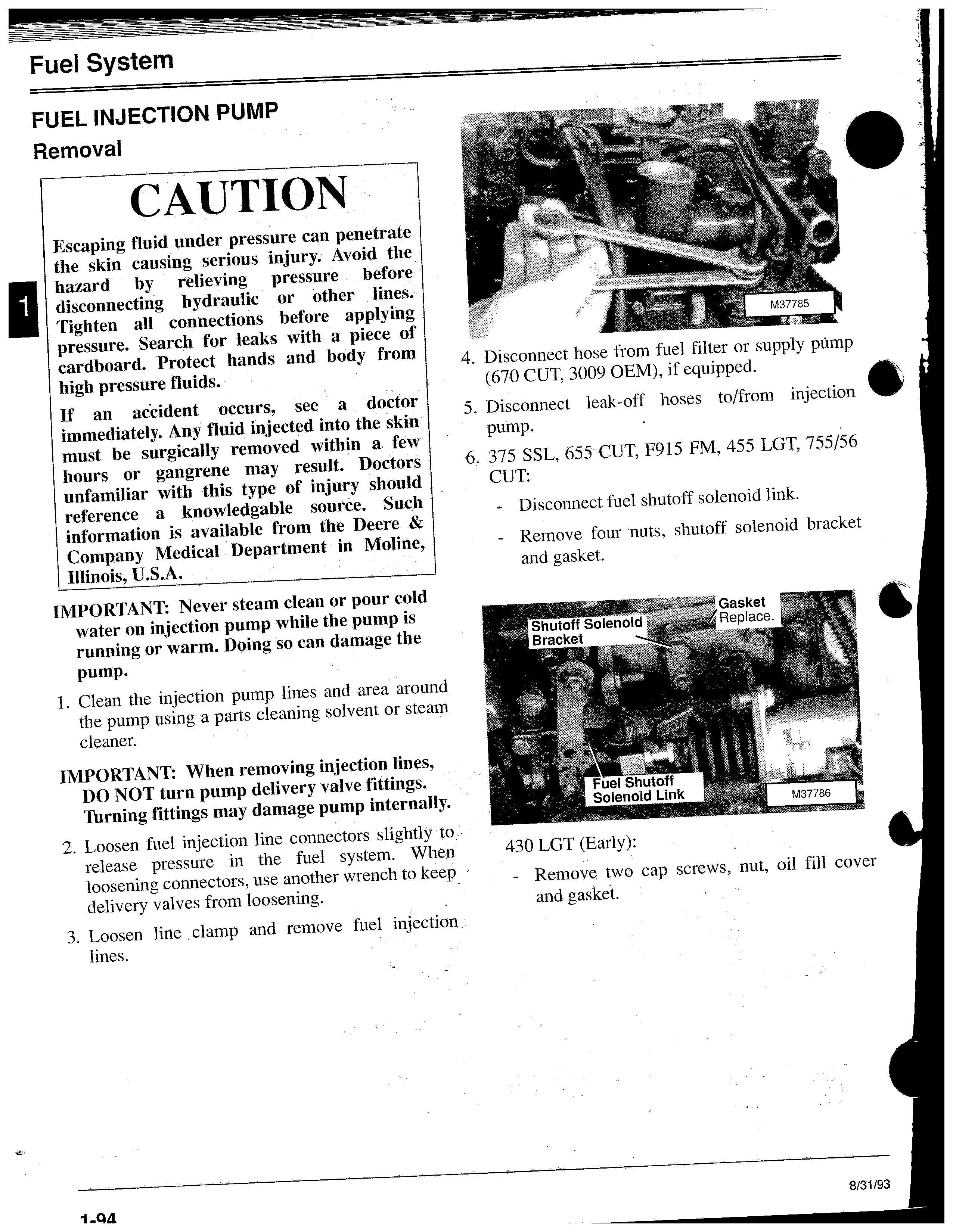

hey guys new to the site. i just picked up a f915 has been sitting for 6yrs ran when last parked i need to pull the injection pump. It looks simple but it seems to be i am missing something can't get it out and are they rebuildable any help would be appreciated

I don't even have the injector lines hooked up to the pump. I am use to way bigger diesel motors than this toy haha. I did loosen the 4 nuts on top when the lines connect to the pump I got it to move alittle. From the looks of the parts breakdown on the JD website looks like it should pop right out
   / F915 injection pump #6
There is a governor linkage under the fuel shut-off solenoid bracket that has to be disconnected.
Note the warning about shims.
hoss puller thanks for the 2 pages thats exactly what i needed to know
