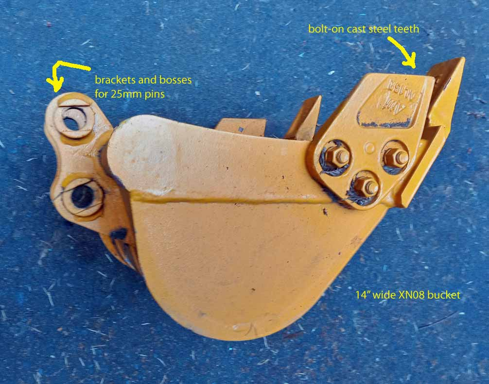

I recently imported a new mini-X from China, and it has been very useful. The buckets that came with it, however, leave a lot to be desired. They are too flimsy, too shallow, and use soft cast steel teeth.
This will be the 2nd bucket I have made from scratch, since I made one for my tow-behind mini-X, the CADDigger 728. Fabricating that bucket, back in the mid-90s, showed me how NOT to do it next time. BTW, the CADDigger designer (CADPLANS) is a TBN member. That bucket was 12" wide, and the carcass was 1/4" steel plate. Bending it into the curved shape necessary was tough, requiring lots of force and O/A torch heat.
First, let's look at the OEM 14" wide bucket and how it is made.

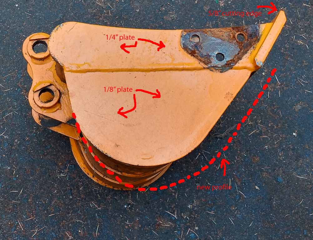

So here is my plan:
My mini also came with an 18" bucket, which I modified and used primarily. I also used the ripper tooth that I bought at the same time. I have about 120 hours total using these two implements to dig trails and remove small stumps and large rocks.
I showed the modified bucket in my Chinese Mini-X thread:
Primarily, I welded on homemade sharper teeth. Worked great. The ripper tooth also works great, unmodified.
The 18" bucket is too wide for many applications (e.g. trenching), and it is too shallow and easy to bend. So I plan to make a deeper, narrower bucket with more reinforcement, plus homemade teeth.

Dissecting the OEM bucket....
I reused the pin bracket and support tube, plus the cutting edge is 5/8" thick, so I reused that, too. The curved section of the carcass is 1/8" steel plate, which is far easier to bend, vs. the 1/4" plate I used last time. 1/8" steel plate wear strips will be welded onto 1/8" plate, as the OEM did. That gives you good strength, but far easier fabrication.
I will also increase the side carcass thickness to 1/4" steel, with a reinforced edge that makes it a total of 1/2" thick there. My total width will be 12", which is a good compromise for trenching and digging, but less likely to get clogged with sticky soil. My tractor's backhoe has 100s of hours on it with only a 12" bucket.
When cutting apart the OEM bucket, I noticed that the support tube was quite substantial, similar to 2" OD, 5/16" wall DOM tubing. I placed some 2" OD 1/4" wall DOM next to it in photo for comparison. Nice.

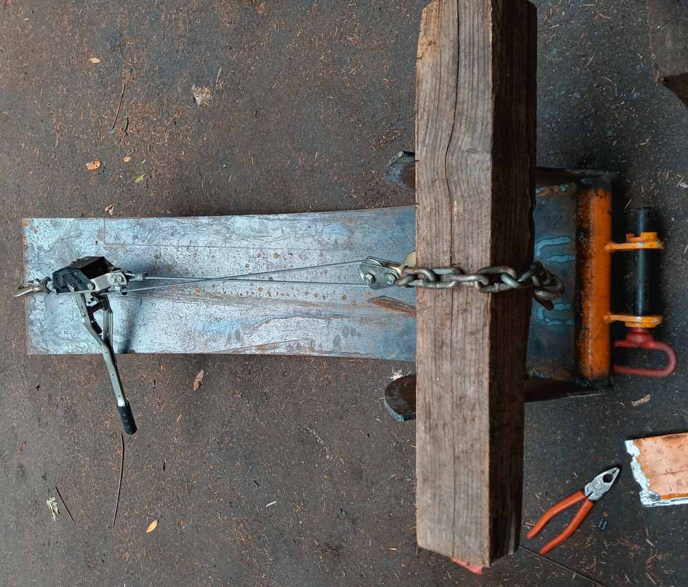

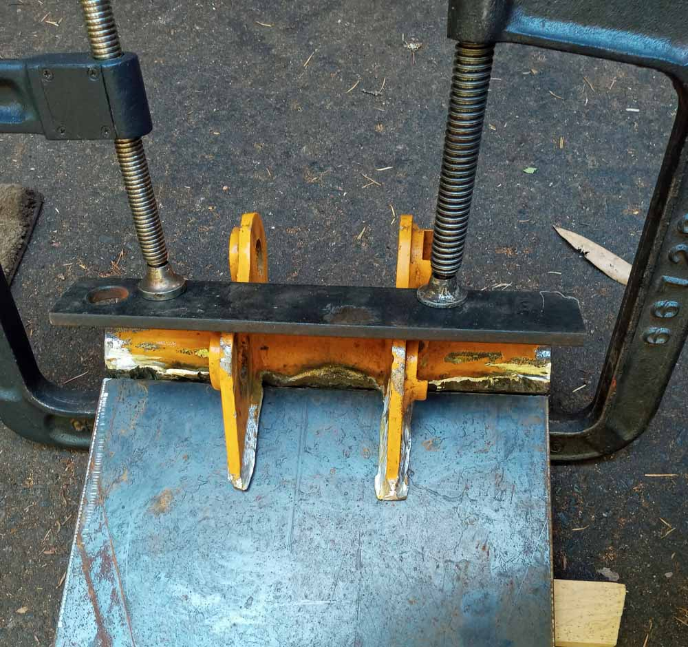

Next, I clamped and welded some 12" A36 1/8" steel plate to the pin bracket and cross-tube. The side plates were then aligned and welded to the cross-tubes.
Bending the plate around and tack-welding was the next step, which used a cable come-along. I welded the plate inside the side plates (rather than on top), for a longer-lasting welded junction. Large C-clamps were also used.
Lastly, I reused the cutting edge, added wear plates, side reinforcement, and a lifting hook.
I also wanted a 12" bucket with one central ripping tooth, rather than three. This allows me to use the bucket as a ripper AND a bucket. Works very well. The tiny teeth in the two corners were more for reinforcing the corners (the first place I usually see cracks).
