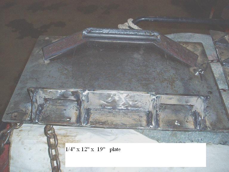

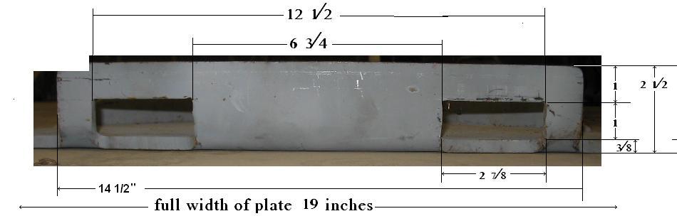

IIRC someone once posted a drawing, with dimensions, for the attachment plate on the 425. Darned if I can find it now.
Does anyone remember who, when, where it was posted? Anything that might help me find it.

I beleive it was stray that posted it.

I took these off a picture that I had saved. Maybe Stray can verify.
BOTTOM 20 7/8
SIDES 4
TOP 9
ANGLE CUT 8 1/4 @45 DEGREES
   / Fabricating plate for 425 #4
Here are the pics I had. Also measure the pts plate to help with the dimensions (the male one mounted permanently on the tractor).
   / Fabricating plate for 425 #5
The other pic

Picture of a Home made one
