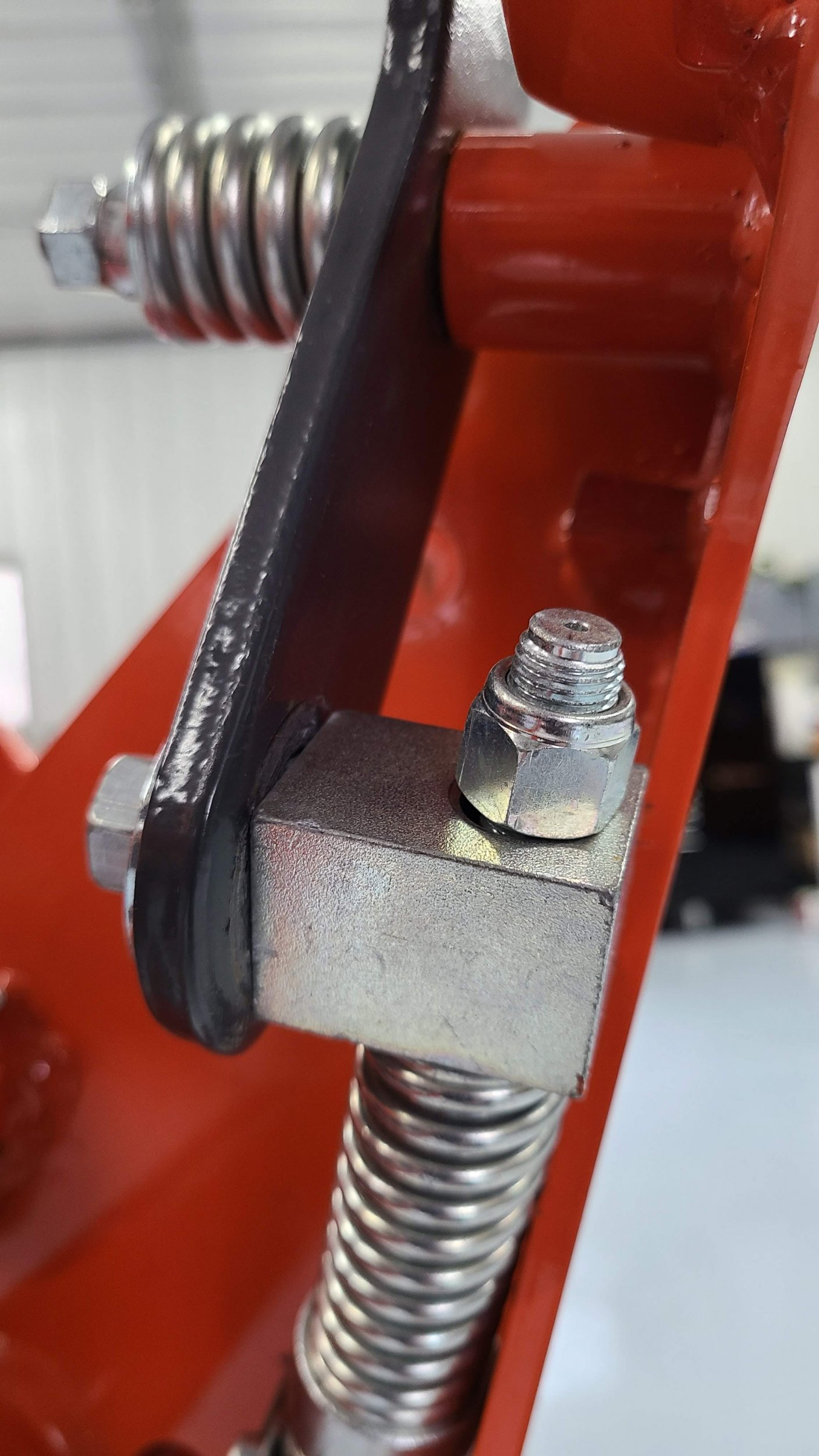

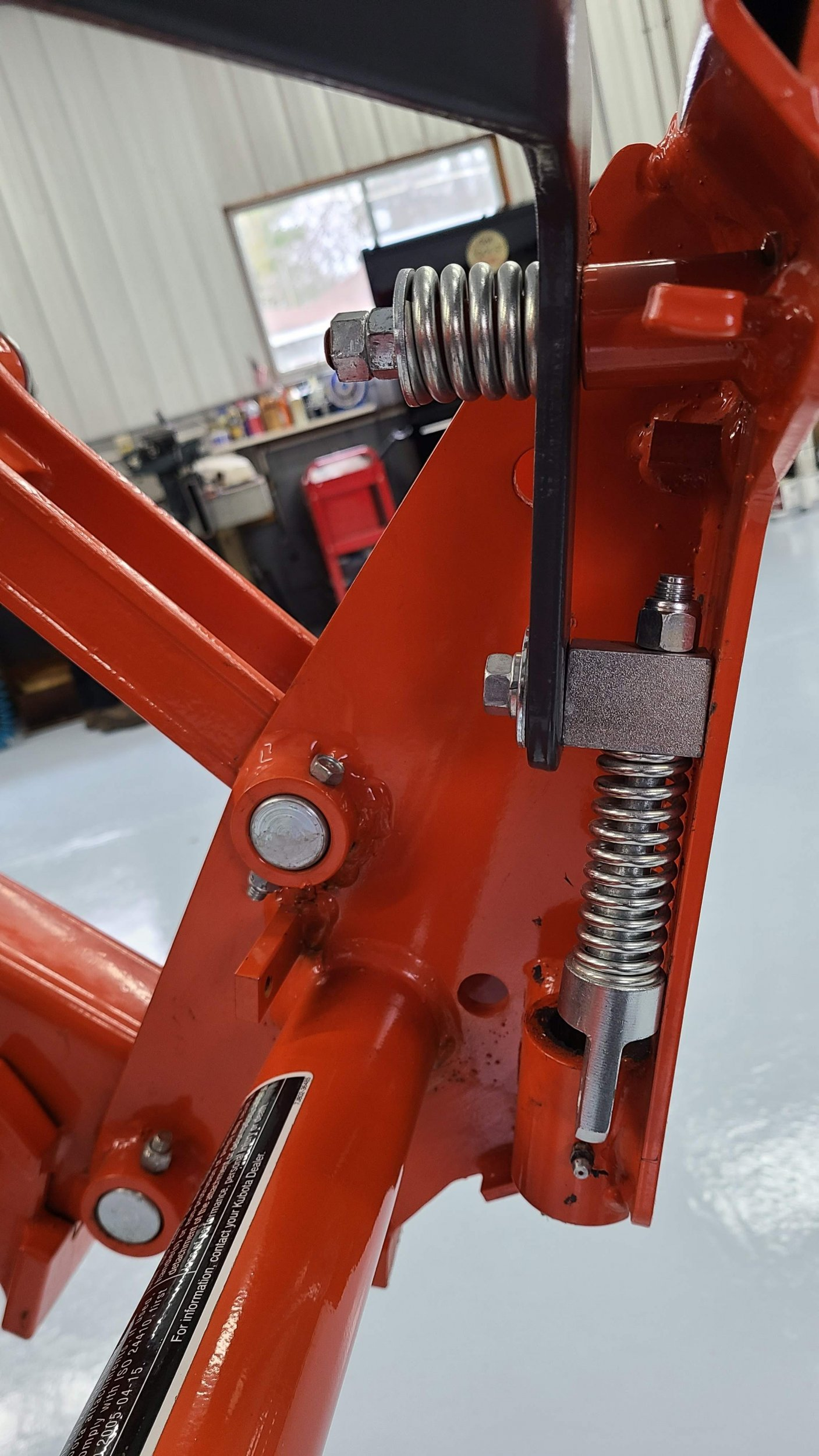

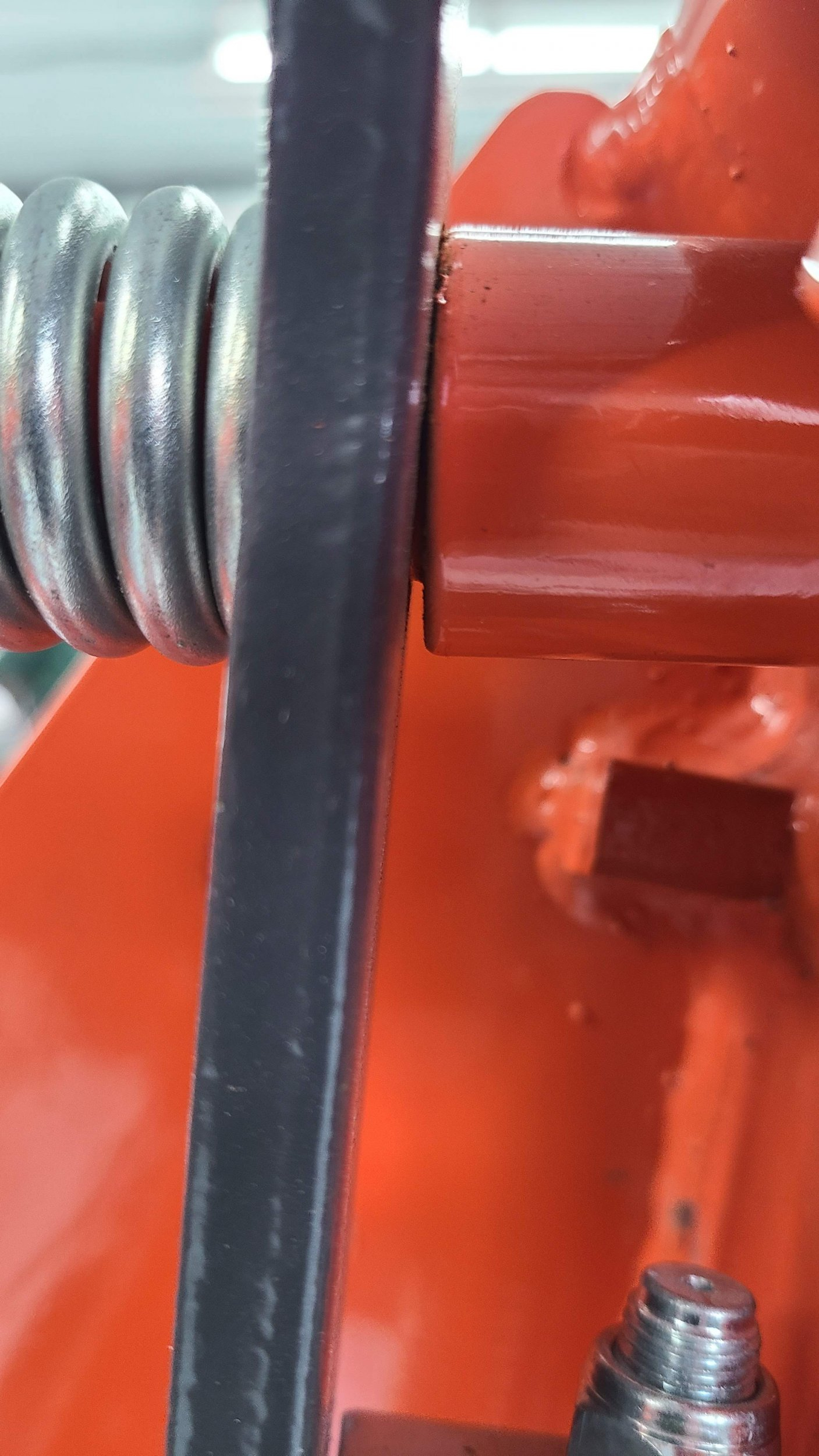

Don't know how this got the passed inspection... latch on one side extremely hard to engage. The stand off for the handle was welded at a downward angle pushing the latch mechanism into the plate when trying to engage. Working on getting the pinned on frame replaced via warranty. Have to say someone at the factory let this one through...
