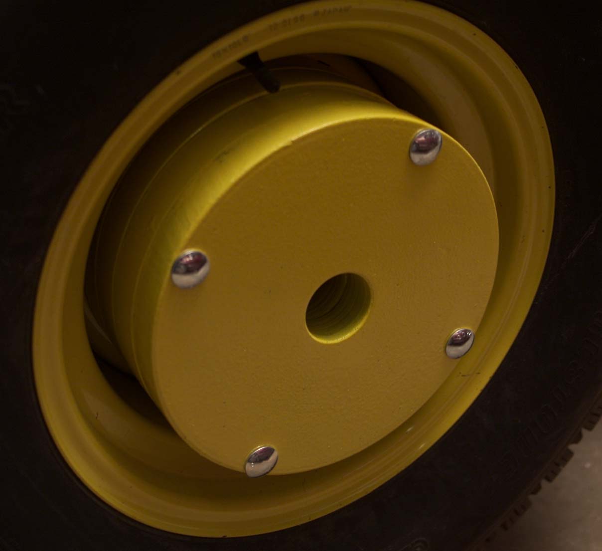

When I put the snowblower on the front of my 4100, it was recommended to add 120lbs of weights to each rear wheel.
This wouldn't really help take any weight off the front wheels, but I suppose it improves stability and adds traction. I haven't had any traction issues without weights, but I thought I should look into getting some in case I ever do find myself needing more traction.
I was very surprised by how expensive the JD factory wheel weights are!
I decided to make my own. I used 25lb weight plates. About 11 inches diameter x 1.5 inches thick. They cost 40 to 50 cents per lb at a used exercise equipment store.

I bored four 5/8" dia. holes on a 10.0" dia. bolt circle in each weight.
After painting they are mounted with ½ x 8" carriage bolts. I used the carriage bolts because they don't leave any sharp edges sticking out of the wheel to snag on as you walk by the parked tractor in my crowded garage.

I was going to match the 10.5" circle of holes already in the wheel for the factory weights, but the diameter of the plates was slightly too small for that. Instead I ended up slotting the holes in the wheel to accommodate the 10.0 dia. circle of holes on the weights. I didn't want to remove the weights just for a photo, but in this close-up of the nut on the inside of the wheel you can see that the hole is slotted.

A stack of 4 on each wheel adds 100 lbs. and is just flush with the edge of the tire.
With longer bolts you could fit 125lb or maybe 150lb on each wheel this way. If the wheels were flipped to the wide position, 5 plates should still be recessed in the wheel.
I think the overall look is not too bad and was a lot cheaper than the factory weights.

I looked at the design of having a base plate with center post, but I wanted to avoid having the plates be loose to rattle around. I wanted them bolted them on tight. This design does however share some of the same knuckle-busting attributes of mounting the factory-style weights. You have to hold 100 or 125lb of stuff up on the wheel in the right place while getting the bolt in place and starting the nut on the other side of the wheel.
In my case, they will only come on and off once per season. On for winter plowing and snow-blowing, and off for summer mowing, so its not a big deal if they take half an hour to put on or take off.

Looks great! There's one thing I see that you need to address. Put a flat washer in between the lock washer and the wheel. The split in the lock washer is going to turn and line up with the slot in the wheel and it'll lose tension. If you drop your weights in the field it will mess up your whole day. :(
