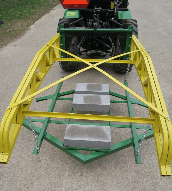

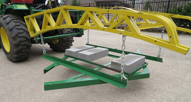

The correct tool would probably be a land plane. Typical farm implements aren't going to get you where you need to go. You don't show info on what you have in the way of a tractor, but simple land planes are easy to construct. Mine is far from professional, but with a little work it will leave a perfectly smooth surface. (Then my moles will ruin it again.)
The lifting arrange is just me being fancy. It can just be dragged.
The lifting arrange is just me being fancy. It can just be dragged.View attachment 693615View attachment 693616
Couple of hours fabrication on the land plane, couple of weeks for the lifting frame? :ROFLMAO:
