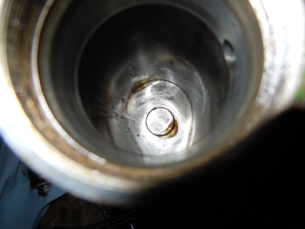

Hi,
I started using the Deere 7 backhoe that I bought over the winter. It is at least 20 years old I think. After 10 minutes of using it, I noticed that the bucket cylinder would not retract anymore or would do so extremely slowly or with help. I went back to the garage and disassembled it. I had never done anything like that but I figure it should not be so bad. I made my own Spanner Wrench and it went well.
I was hoping to just find the failed seals/packing but instead it seems I found that the piston had rubbed against the tube in a few places and I am afraid it is ruined. I don't know much about hydraulics. I will head to the local hydraulic shop tomorrow and have them take a look. What I thought would be a quick and cheap fix will probably end-up being a costly replacement. Dimensions are 2" bore, 13" stroke and 1" rod.

Are you sure the rod was not bowed? That might cause the piston to rub the cylinder wall.
   / Failing packing ruined bucket cylinder on Deere 7 backhoe
It looks very straight to my eye. The packing was so bad it went in between the washer and the tube on one side so I suspect the opposite side was pushed against the tube and rubbing. Again I don't know much about hydraulics...
   / Failing packing ruined bucket cylinder on Deere 7 backhoe #4
At this point it is probably cheaper to buy a new cylinder, especially one so small. If you fix the barrel you still need to be sure about the rod (don't eye ball it), then you'll have to measure up the piston because it is damaged and likely is out of tolerance.
Unless the cylinder is hard to find, or overly expensive; if two components are bad it is cheaper to just replace it.
Hydraulic shop confirmed that it was shot.
I purchased a generic 14 inch cylinder and had them shorten the rod 1 inch to be closer to original cylinder retracted length. All together with fittings it got to right around 200$... I'll put some green paint on it tonight and put it back in place ASAP. Looking forward to see how it will work now.
