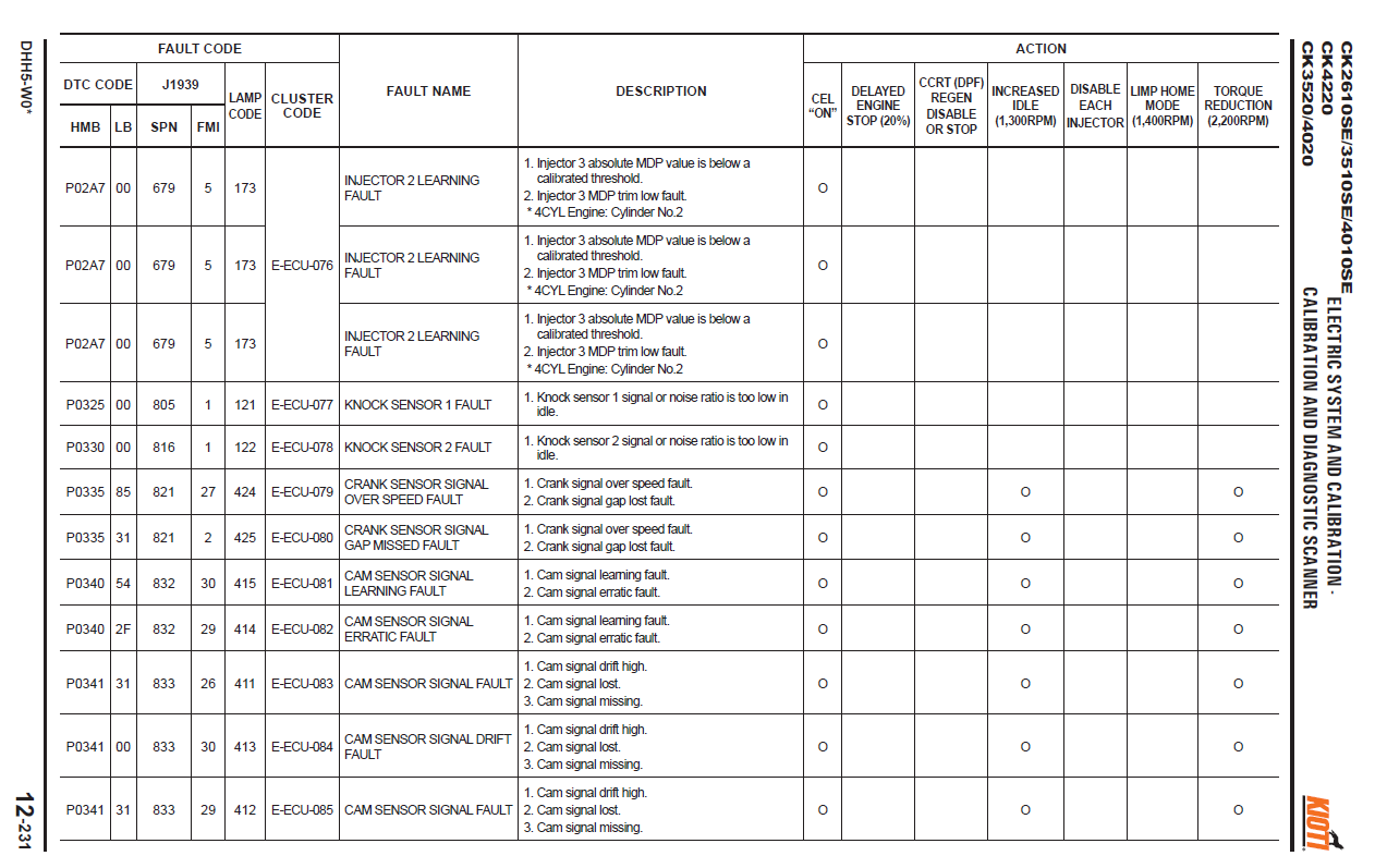

Kioti CK 3510 se
Service engine light on
Getting Codes DTC 833 F029, & 833 F026
where can I find descriptions and how to reset service engine light
   / Failure Codes #2
I have looked for the codes also. To me it seems KIOTI is not allowing that info out to customers. Service techs only at the dealers can look them up or call KIOTI but it seems they are reluctant to tell owners the meaning of a specific code. Not sure if that's true, but I've been unable to find a listing of codes and the meaning.
   / Failure Codes #3
Closest I've found was this. Something to do with the cam sensor signal. Could be just wire damage or plug.
