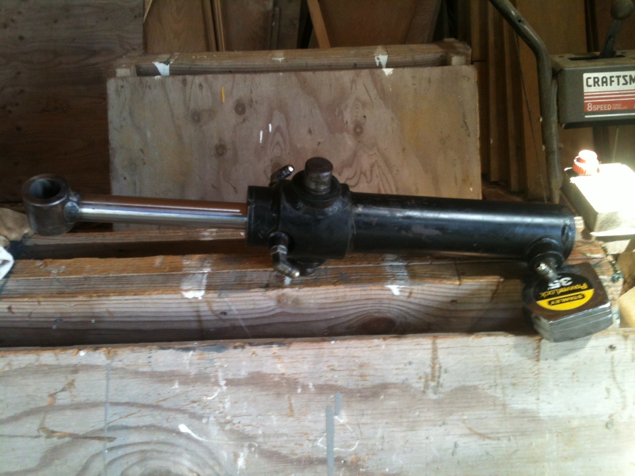

Hi guys,
Just bought a decently maintained 1999 Wood BH9000 backhoe. One of the swing cylinders is weeping hydraulic fluid, so I pulled the cylinder and I'm about to call around the local shops to get estimates on repacking the cylinder. It's a three inch diameter cylinder, about 15 1/2 inches long (not including the rod).
Any idea of a fair price range to expect for this kind of work. I've inspected the cylinder itself, including the rod extended, and it looks like all I'll need will be the repacking around the gland.
Should I also make sure they replace the seals around the piston, even if that shows no signs of deterioration?
Many thanks,
Jed
I've attached a photo of the cylinder.

Around $150 in this area, assuming you won't need anything more than seal kit and labor
That's not a hard one to repack if you are mechanically inclined

All seals should be replaced while it's apart, it's not anymore work cuz the cyl needs to be completely disassembled anyways...:2cents:

Seal kit should be $50-75. There are several threads which talk about rebuilding cylinders. As a previous poster stated, if mechanically inclined, you should be able to review the old thread and be successful. I recommend taking a photo or two of the old packings before removing for reference when reassembling. The newer seal kits may not be an exact match as technology improves over the years, so do the seal kits.

First thing I would do would be search online for parts. Price them.
then call around. We can all tell you what it costs in our areas, or what we think, but you need to make calls in YOUR area. And if any of them are going to charge more than $100 in labor, I would be looking to do it myself. (actually if it were mine, I wouldnt even bother with the shops and be doing it myself anyway)
