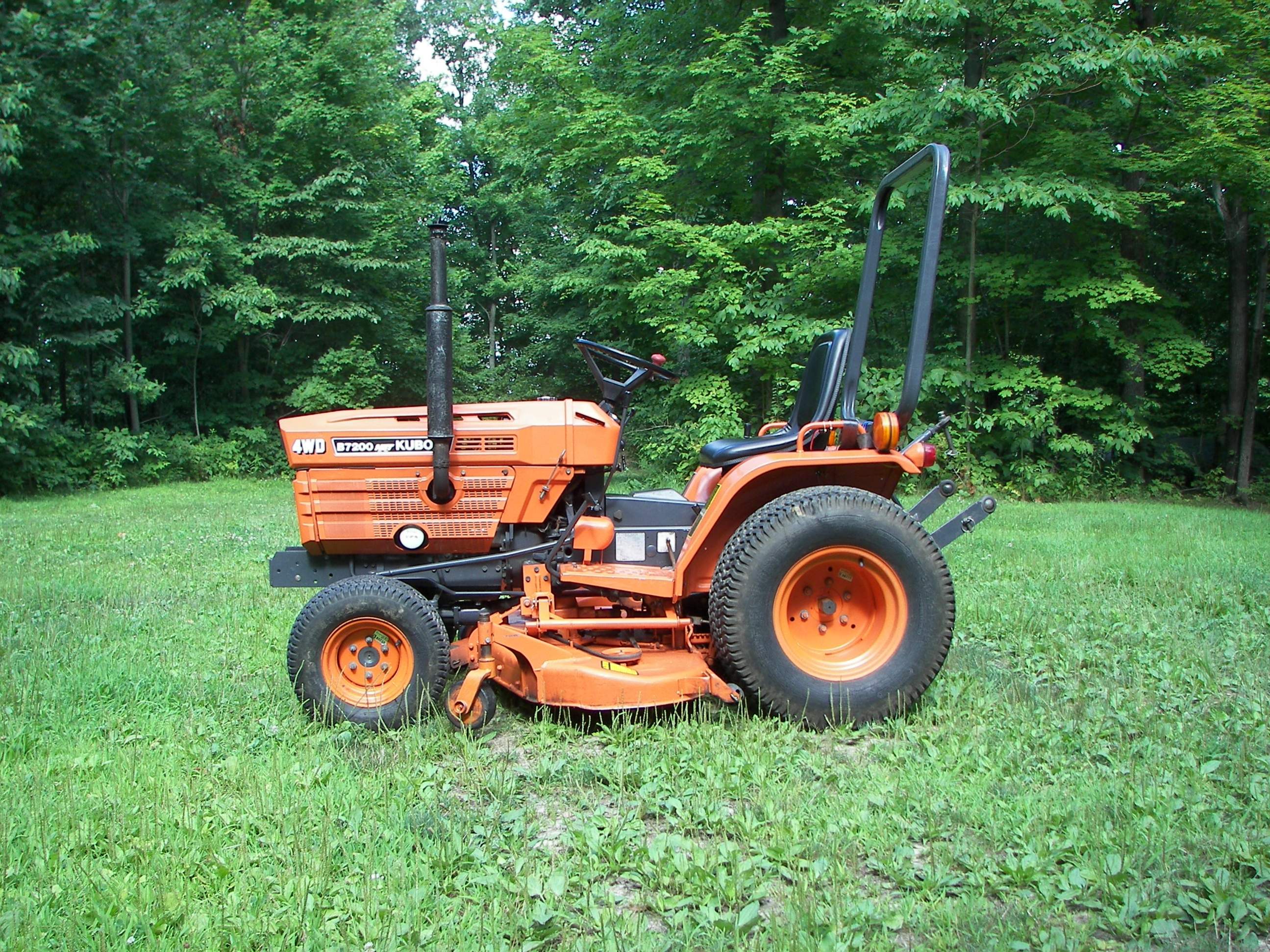

There is a B7200HST 2/4WD for sale locally. It comes with a scraper blade and 60" belly mower. There are only ~680 hours on it. It looks like it's been kept outside for most of its life. It's an 89 model. The paint is badly faded, the mower deck looks a little rough, blades very dull.... The turf tires are weather cracked. The oil filter was clean and looked new, at least on the outside. It started easily and seemed to run well.
I plan to examine it a little more closely.. What are some things I should look for? All I've owned up to this point are riding mowers...
They are asking $7200, which seems a bit steep to me. I was wondering what a fair offering price would be?? I was thinking $4500 to start, maybe going up to $5500. Am I in the ball park?

I was only able to get $3700 out of mine in my area. I started out asking $4250 last fall and then listed it for $3950 this spring. It was HST, 4wd, with 834 hrs, with 60" MMM and turf tires. The tires were weather cracked, but still held air. The guy who bought it said he was going to put new tires on it. He said he came out thinking it was a $3500 tractor and after seeing it decided that it was worth more than that so I met him half way. Mine had been repainted by a professional before I bought it 7 years ago, and it had a new seat on it. I think it had set outside quite a bit also.
You might want to check the brackets that hold the MMM on. When inspecting mine we found that one of 2 of them had been welded on with the bolts still in them. They are only supposed to be bolted on. I would also check the air breather pipe. Mine did rub some on a sharp piece of metal, check it to see if it has any holes rubbed thru. Check the decompression pull (black knob on left side of dash) to see if it works. It really helps those old tractors start in the winter. The cable was froze on mine, but I would just open the hood and activate it by hand. Try and find a way to test the locking diff as well. I always had a hard time getting mine to work.
I attached a full resolution picture, so you can have an idea of its condition.
Good Luck. :)

Thanks for the replies. Brier, yours looks nicer than the one I'm looking at. I may offer her $3600 and hope she's not insulted. :)
