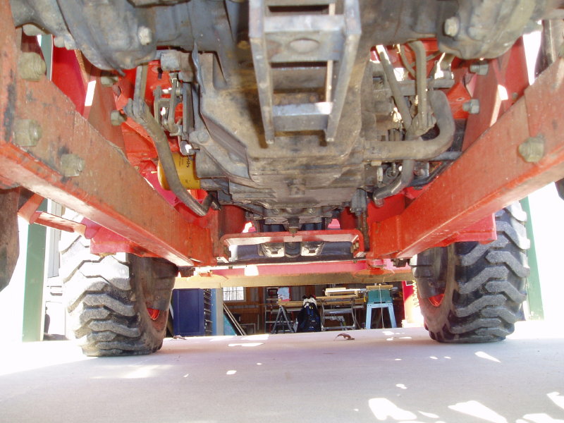

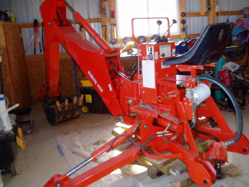

Here are photo's of the tractor with backhoe, the dis-mounted hoe itself and the subframe. The tractor is an L4610, similar in size to the MX5000, also with the LA852 loader.

Thanks Grandad4, the pictures are great! What a beautiful machine! I didn't realize quite how substantial the subframe was, really impressive. Clearly this isn't some toy backhoe like some of the smaller models. I am zeroing in on this setup, if the price isn't too high. As regards backhoe's my last machine was a Case 580 Super E extendahoe, so I really am looking for something substantial, obviously a 4560 isn't in that class, but for a midsize machine the 4560 looks to be perfect. Your comments definitely help!
