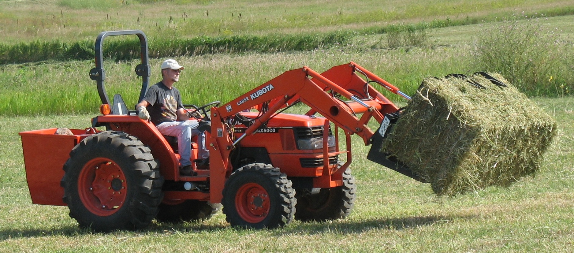

I'm glad I got a grapple with two arms. Try handling 800 lb. large square hay bales.

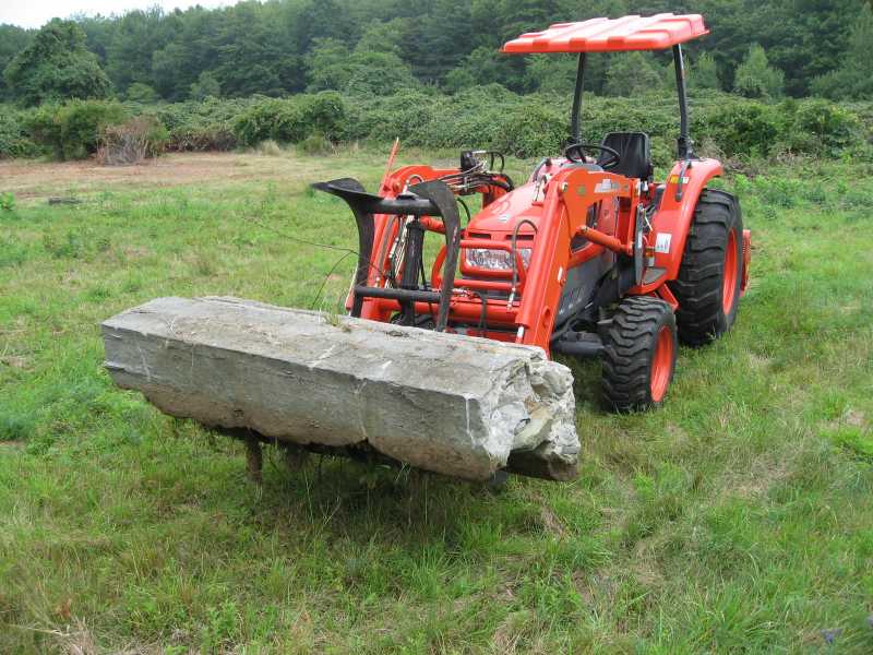

Unfortunately I don't have access to a 800lb square hay bale to test but I don't see any reason that would pose a problem for a single grapple. The bale could easily be lifted and would be stable without movement on the bottom of the grapple with the top grapple needed to hold it in place when moving. I've never had a problem carrying significantly longer or heavier loads of logs or big slabs of concrete. Photo shows a heavy concrete slab about the length of the hay bale you showed. Seems like there is enough clearance above it for the grapple to clamp on a haybale. Is your concern that the hay bale would come apart if only held in the middle?

These large square bales require a lot of grip to pick-up-roll. I am glad I had to arms biting into them to get them up on the bottom tines. The way that they come off the baler they have the twine on the top and bottom. If you tried to get the grapple tines under the bale you will bust them up so you have to grip and lift and then roll back onto the bottom tines. Maybe your one arm is stronger than one on my grapple but I think with the material your handling it might just pull through with only one holding it.
