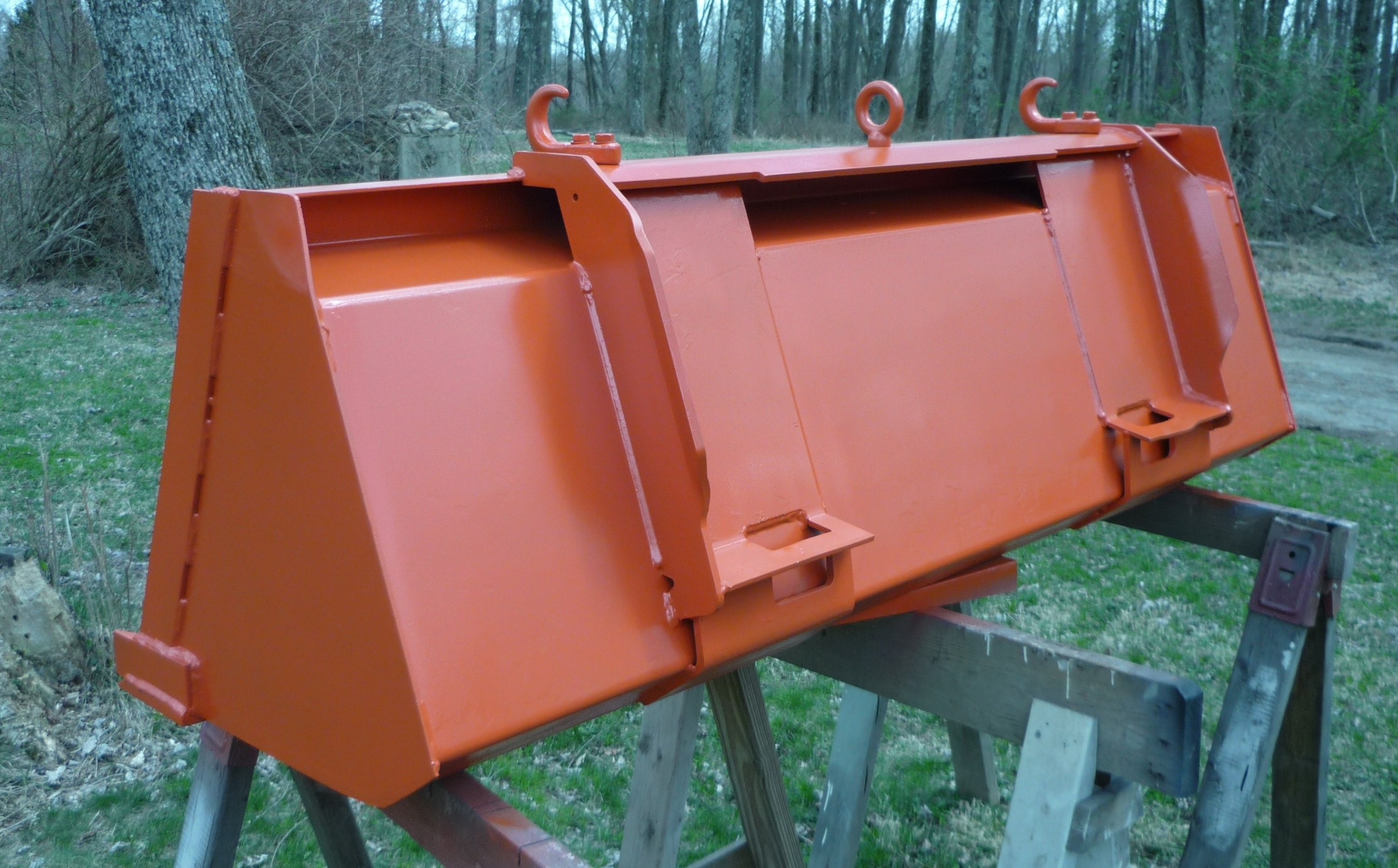

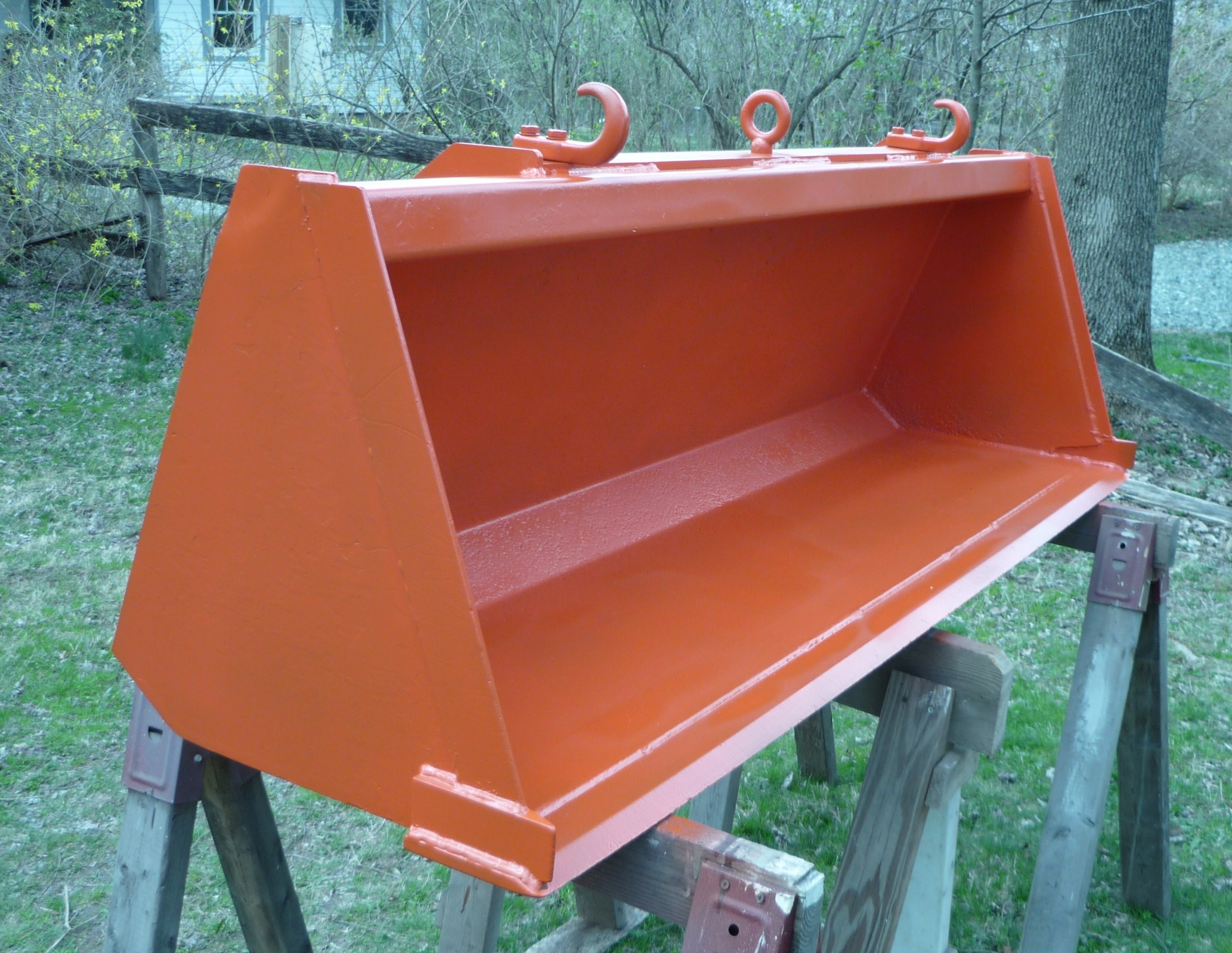

I find myself struggling on what to do with the 4230.. I won't be able to disassemble the entire tractor and sandblast each part and I'd rather not sandblast while it's assembled. But I can definitely wire brush and clean it. The struggle is if it's worth spending some money on high quality auto paint or just going with John Deere paint or even magic or valspar.
   / Fall/winter project #19
I haven't sprayed a whole tractor, but I did sandblast, prime and finish a 72" loader bucket. I gotta say, I used two part epoxy metal primer, and that stuff is great! I finished with Kubota paint, and it was also good- fine coverage, dried well, etc. I did this outside, using just an organic vapor respirator and Tyvek suit. The thinners are very explosive when sprayed, so I wouldn't even spray in an enclosed area where an air compressor was operating. All the finishes I have seen have pretty explicit temperature and humidity parameters. If outside, don't forget about drift!
