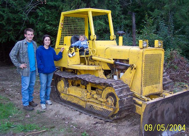

Since I'm fairly new here and think I may hang around, I figured I would show you who I am and what I play on.
It's an international 500c from 1972. 6-way blade and 45 HP diesel engine. Once the bigger tree flipping and grading work is done then I plan to resell it to purchase a more expensive tractor for maintenance and finish work.
The little girl driving is my 2 year old daughter. Mama's cooking another one as we speak.
We are clearing the 15 acres of young forest on the weekends a little at a time. It is about 45 miles away and I don't think we can live there so long as I do the 9-5 without some major lifestyle compromises, mainly a loss of free time due to the commute.

Glad you qualified. I opened the pic after reading the first line and thought "wow. so small but can read, type and drive". I see now, you're on left side of the picture.

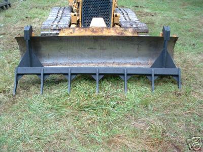

The rake is not complete in that picture. The ends are now capped, there are also holes blown through the main beam for the vertical pieces that will go up to the top of the blade. This picture is what I was going for. Materials were well over 1000 bucks with steel prices how they are so I went scavenging at my employer's shop. The beam is 1/4" thick well casing (a bit thin, the weakness) and the tines are 1-1/4" solid grade 8 bolts. The bolts were 42" long and used to hold lights to the foundations. I have the rest of the parts cut but not welded yet. It will be a clean up rake since I fear I will ruin it if I try to use it as a root rake. I will use it to push the material towards and into piles for burning.
See the attached photo for my inspiration.

THats a good looking 500C theres not too many around these parts, I found one with a bad final drive for 2400 bucks with a new undercarriage and factory sweeps with a 300 hour engine in it. I need to find the final drive before I buy it though. One thing on a 500 if its lkke most and has the scarifier on the back find an old cheap 3 point toolbar chisel plow and make a reciever to mount it onto the ripper. Makes a great pull behindbrush and root rake. I did this to a friends 350 Deere and it wont make a bigh pile but it rolls the brush up into a long windrow. You do this till you have a good long windrow then pussh it up into 3 or 4 sections then pile up together.

I will be out there today after work to drop off the repaired brush rake. Turns out it isn't quite up to the task of flipping stumps. I knew this was the case but didn't notice the planted stump hiding in the pile.
