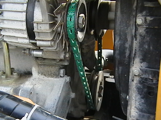

Hi I Farm Pro 2420 I need a fan belt but it want go pass the pulley and frame do I need to remove the pulley to put on the fan belt

I don't understand. After loosening the pivot bolt on the alternator, the belt should come loose from both pulleys. At that point you should be able to simply slip the belt over the fan blades. Depending upon how small the belt is, you might have to do it one blade at a time. But that's how it was put on there in the first place.

This will solve your problem. Vibration Free Link Belt It's better than a regular belt.
I wholeheartedly agree. It will be the last belt I bought. I even put one on the Mustang skid steer.
Welcome to the 21st century! :thumbsup:

I am with Greg. It will go, you just have to hold your tongue right.

I' m alongside Greg, just be sure to watch for bending the rad. fins when pulling belt past the fan tips. Some equipment is very easy to slide the belt past, bending fins on the Rad. causes several other problems later. Jy.
   / fan belt #7
Just one of the sweet benefits of the linked belt that you gentlemen are fighting about - no need to risk damaging your radiator and skinning your knuckles. The linked belt is not new. Been in industry for many years.
