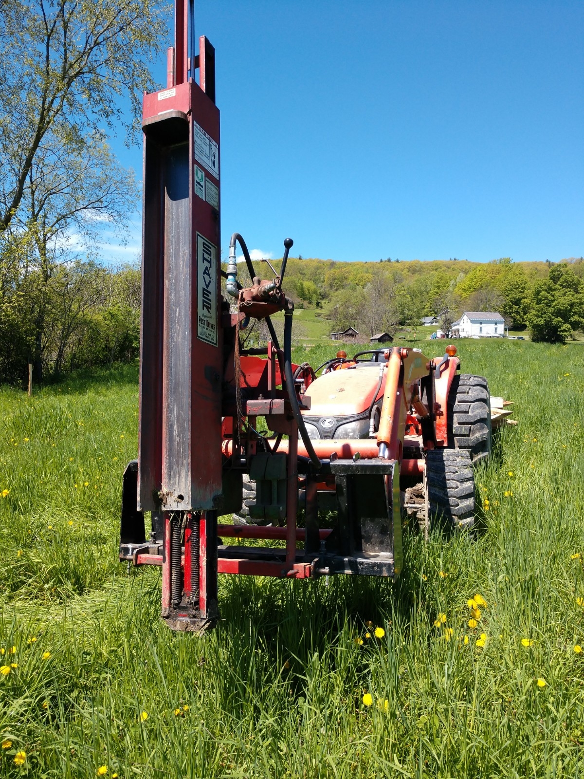

The post pounder will put post down and they are good and solid. The required hydraulic flow is minimal. Many pounders do require a non-restricted fluid return line (open ended hose shoved into the fill port).
We prefer to mount it on the fel as it is easier to reach into the existing fence row, and up into the old fence lines and stone walls, rather then having to back up tight to the fence line. Also works very well on steep road sides and such.
It does make it more of a two person job, one driving the tractor and adjusting the loader height and curl and the other driving the posts. It can be done by one but two makes it faster and easier.
