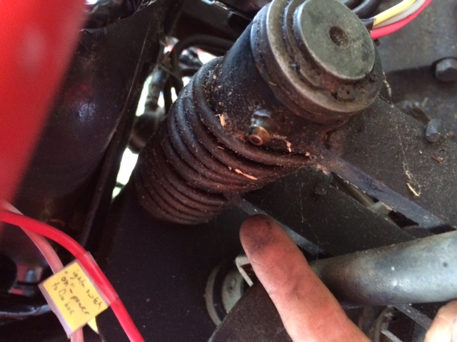

Also, my brake pedal seems to not be returning to its original position once depressed. I cant tell what is exactly restricting it but it sometimes stays down and I have to hook it with my toes and pull it back up!?! Coil springs around the pedal itself seem ok, but Im uncertain of what else could be at fault.

break pedal isnt returning to its original position still. might need to just grease the shaft the pedal rides on, but it seems to be getting stuck halfway back up then it wont return unless I pry it up with my toe. Could it be the springs wrapped around the shaft have lost their tension? see pic
A while back I ordered a brake pedal return spring, its a beefy little spring I just cant tell where it should be attached! see other pic
any help would be greatly appreciated. Im getting there, slowly...

Not familiar at all with your tractor, but those are two completely different types of springs. The one in your hand is a linear retraction spring and would fit to the brake pedal arm in the returned position. The other is a radial retraction spring which could be left in situ.
   / farm pro 2524 rewiring project and brake issue #5
IMG_0091.JPGthe spring in your hand is for the pedal return, it attaches to the pedal arm under the tractor.

Yep, ive searched and searched and there is nowhere to put this spring. No tab attached to pedal or linkage anywhere i can see that would allow the spring to be utilized. Im completely stumped!
   / farm pro 2524 rewiring project and brake issue #8
I think you really need to soak that shaft with penetrating oil so that radial spring can do it's job. Whoever sent you that linear spring sent you the wrong one.

yeah I tried hitting it with the grease gun, but not sure how deep its getting. What can you suggest for getting penetrating oil to, well, penetrate the length of the shaft?

This is the best penetrant that I know of. My bulldozer has a brake cross shaft like yours and it keeps it free. I give it a few shots when it begins to stiffen up.
