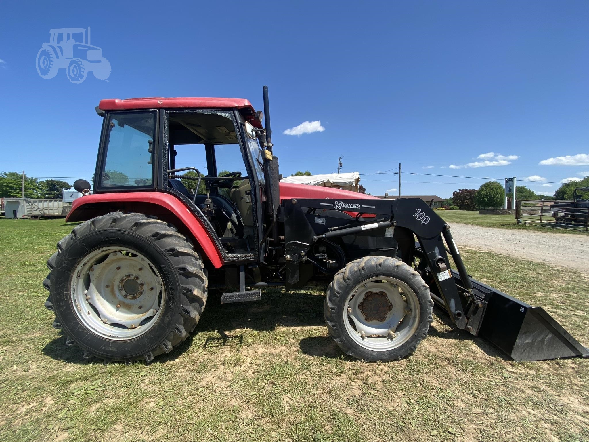

I’m looking at buying a used farm pro 7040
The guy says it runs great but has a small hydraulic leak in the back. I asked if it was a hose and he said it’s from the control bank and that it was an easy repair with a gasket. I’ve never owned a tractor but am at a point where I need one. It will be on a smaller farm so won’t be used heavily or abused. Can I get parts easily, and are they easy to repair if need be. Also how serious is a hydraulic leak at the bank?

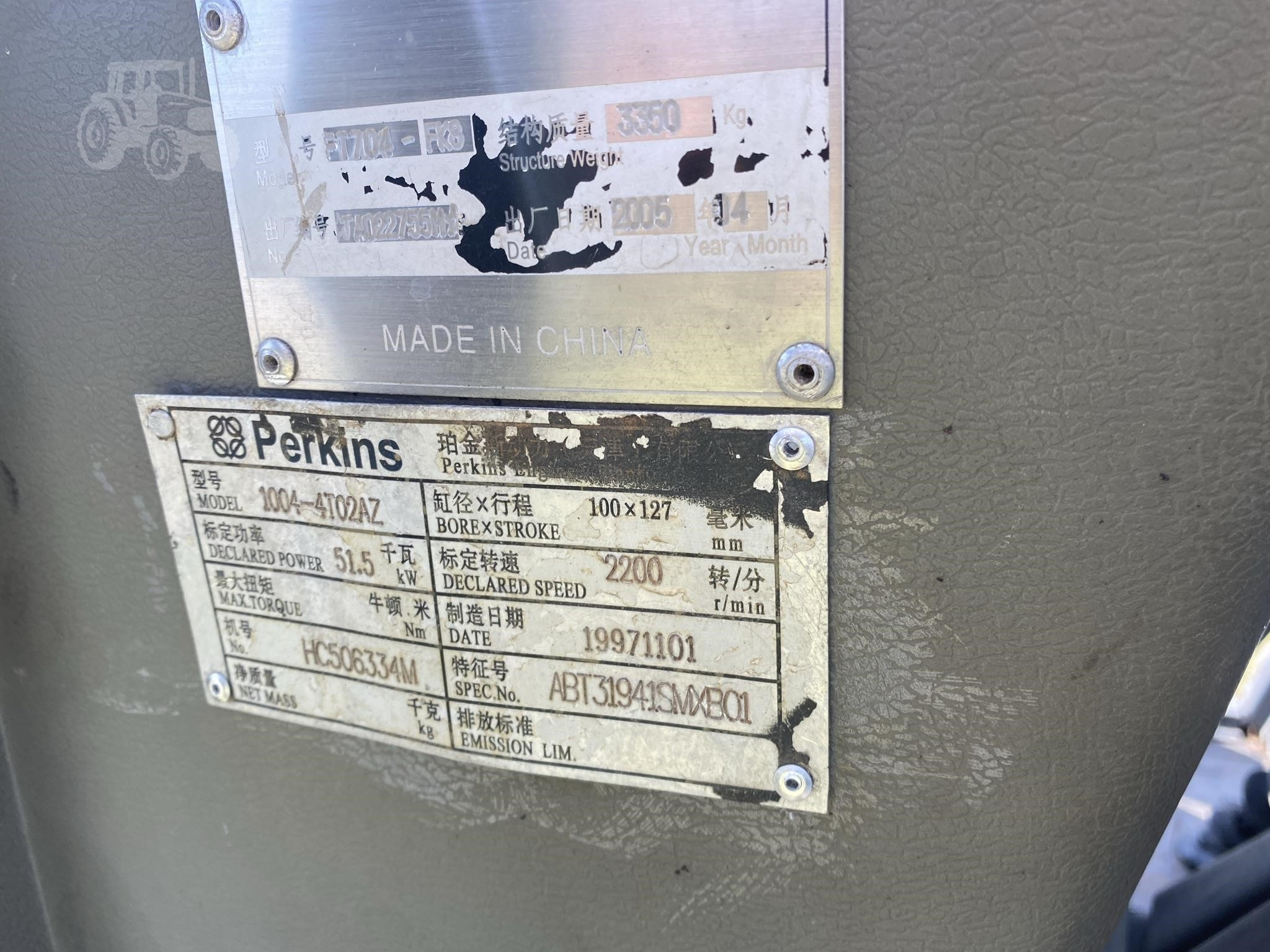

The 7040 has a base weight of 7000lb before adding the FEL
It is powered by a 70 HP Perkins diesel.
Perkins
turbocharged diesel
4-cylinder
liquid-cooled
Displacement: 243.798 ci
4.0 L
Bore/Stroke: 3.94x5.00 inches
100 x 127 mm
Power: 70 hp
52.2 kW
Rated RPM: 2200
Oil capacity: 17.96 qts
17.0 L
Coolant capacity: 15.84 qts
15.0 L

This guy buys and sells tractors and I don’t believe he tries to repair anything.

Is that a good diesel engine? It is a big tractor but for the price he is asking, if it’s a simple fix would be worth it.
/ Farm pro 7040 #7
Yes Perkins makes Very Good diesel engines.
They have been at it for a Very Long time. They actually helped Ford design the World tractor series 2000-6000 engines in the early 1960's which are also long lived engines.

Sure, it’s a cabbed tractor but it was missing all the glass except the windshield and didn’t have the doors. I didn’t care about that stuff. Asking price was $6000 not sure on hours.
