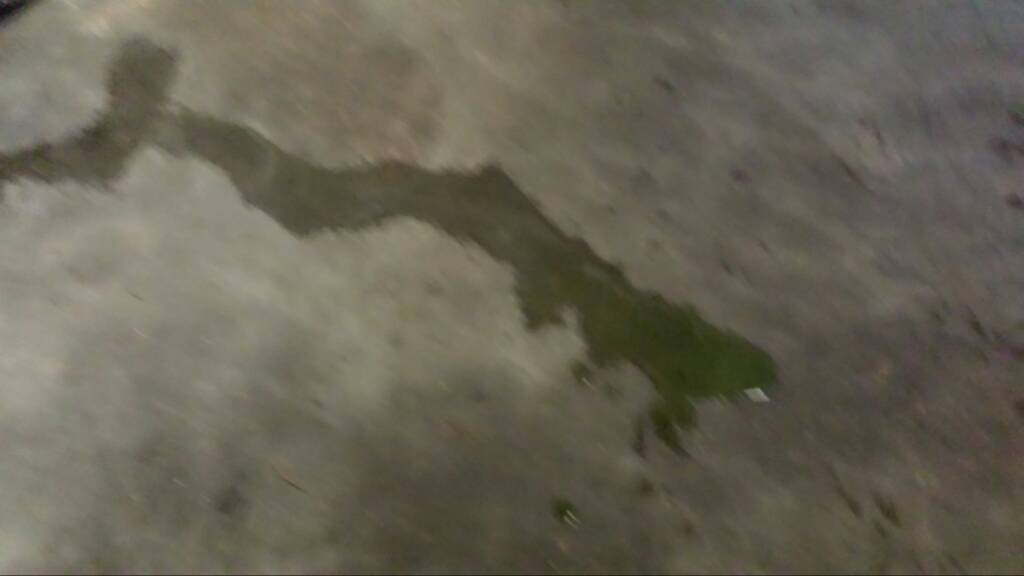

I noticed a few days ago I had a leak where the oil pan is first day was hyd. Oil next day I noticed it had anti freeze in it. What do you think it is? It's to far away to be the radiator but then again I'm no expert.

Not very clear what you are trying to say. Sorry. Can you post a pic of said leak?

I take it you haven't got the tractor real hot because its winter. Probably radiator leaking but could be a hose clamp loose or even the water pump weep hole. I would dry it up and try to find the closest place it's coming from. Good luck.

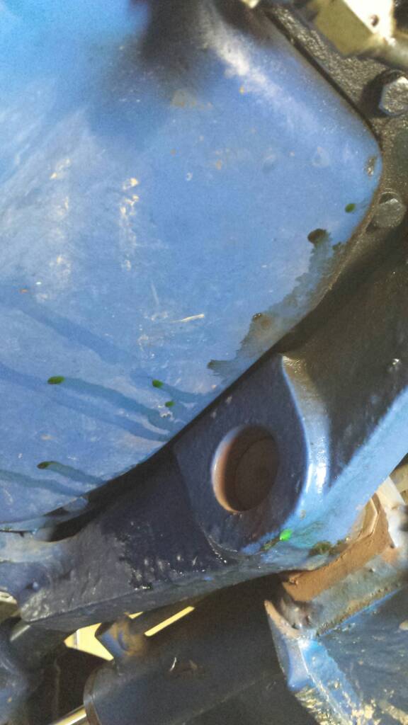

Guessing that is the front of the pan so yes I would guess Radiator leak or hose\ WP leak as said above.
   / Farm track 555 leak #7
You can actually see where it is running down the pivot. I have had 1 Radiator replace under warranty And just had a shop repair a leak that pretty much leaked right there. The overflow tube is also on that side too. If running hot or overfilled the engine gets a bit hotter after shut down and puke a little.

That's how it goes I don't see any anti freeze anymore now just HYD.fulid.

I would guess maybe power steering how is that for level
