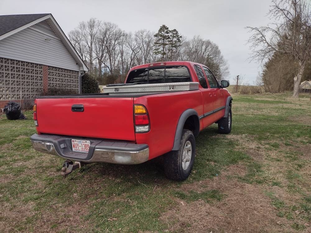

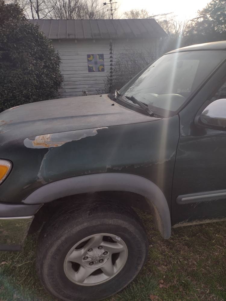

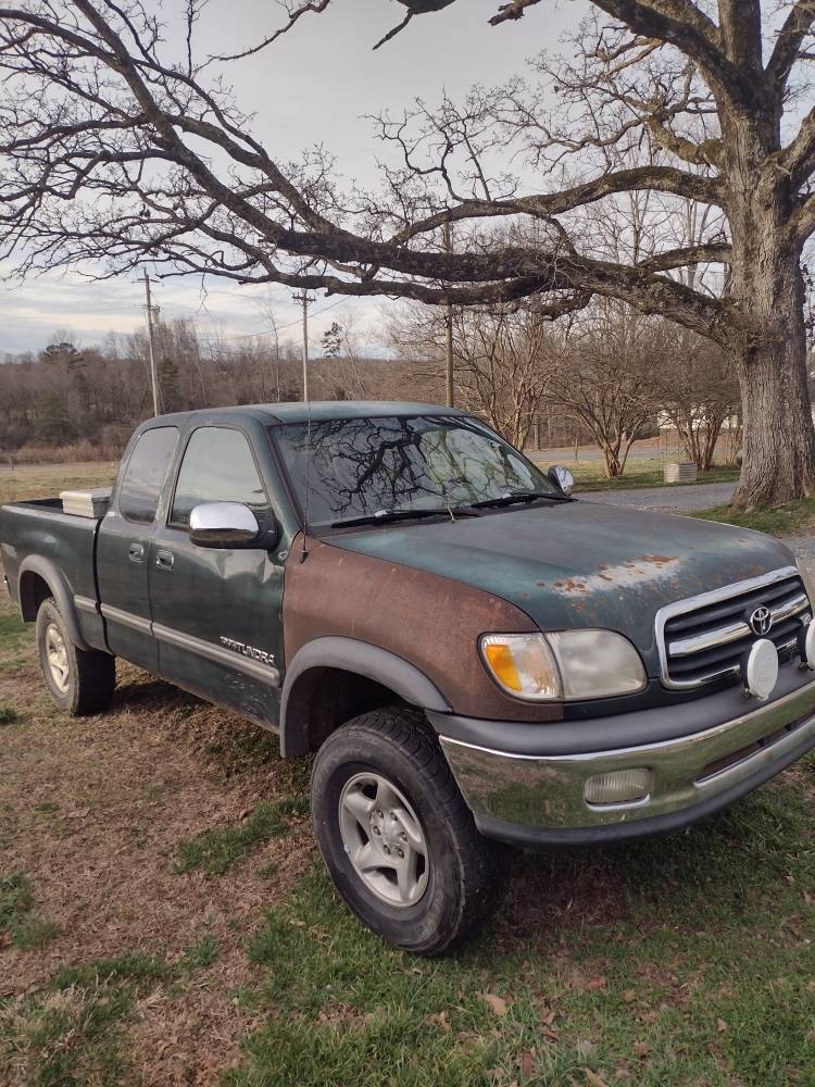

Hello all. My old beater Toyota Tundra was getting looking pretty awful. The truck has 360k miles and interior in not such great shape. I decided to start making it look pretty decent. Now I have never painted a vehicle before at all. So I set off to do some research. I seen on youtube a lot of videos of people using Rust-Oleum oil base paint and it looked pretty decent for the cost. So after a full day of sanding and washing and taping and painting it was done. It turned out ok. I learned a lot. There are some spots that did not gloss over. Has anyone did an oil base paint job and buff it and it look better? Pics are before and after.
   / Farm Truck Gets a Home Paint Job #4
How did you apply the paint?
Lol, thanks for the complements. I applied the paint with a $15 auto spray gun from harbor freight. I thinned out the paint to spray better with a 60% paint 40% mineral spirits. What I read is if you put a coat of wax on it once a year like auto paint it will last for years. But if it dont then you can just buff it down and paint it again for $70.
